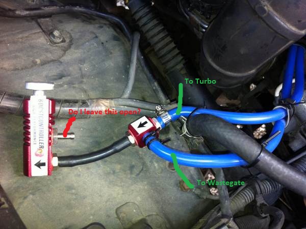

Okay, hopefully i've done this correctly..
I'm going to extend the black hose into the cabin so I can adjust from drivers seat..
Tell me if Ive done something wrong
Okay, just relised ive done something wrong, the black tube and the wastegate tube need to swapped around.

luxsurf wrote:Okay, hopefully i've done this correctly..
Yes it did look wrong... Swap them over...
Also you might find you need to remove the check valve in the Tee piece...
I did with mine....as it was better without it... But try it both ways...
The open end on the controller will vent so put a hose on it and send it back into the engine bay.....
