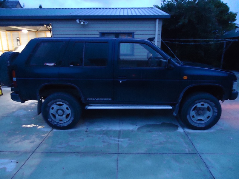

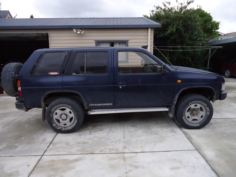

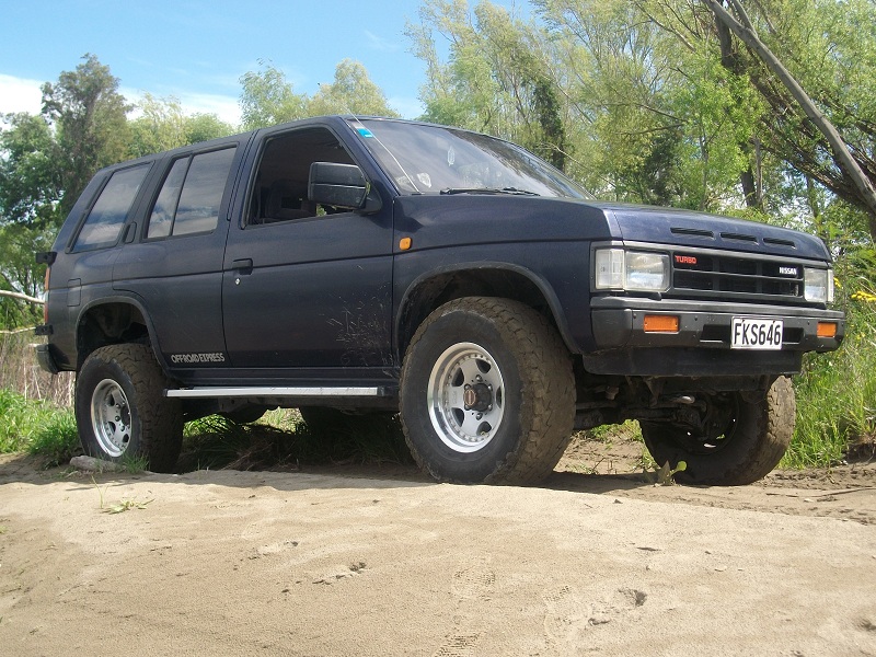

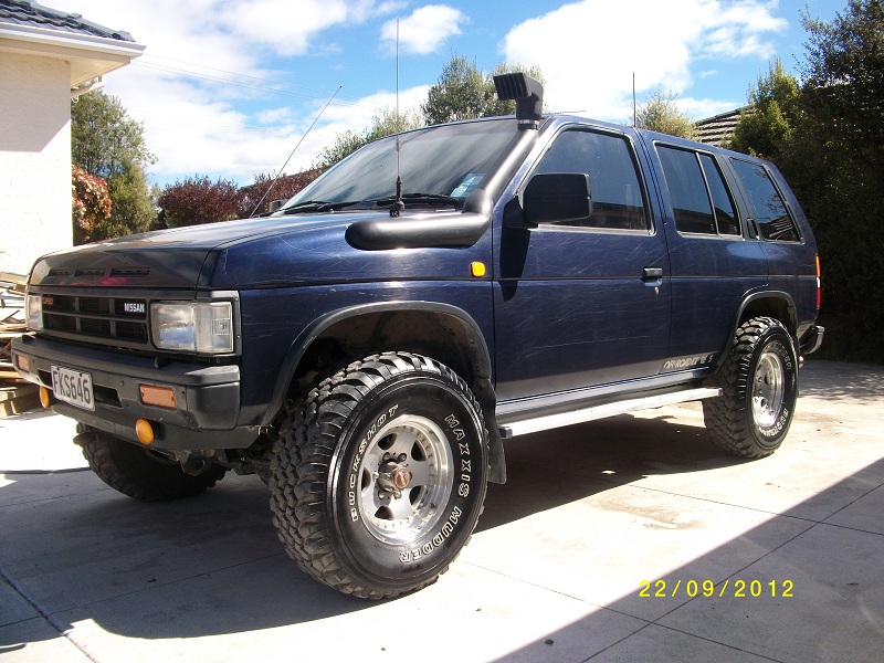

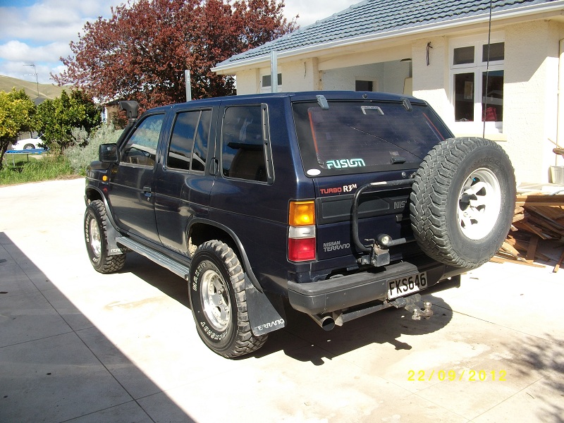

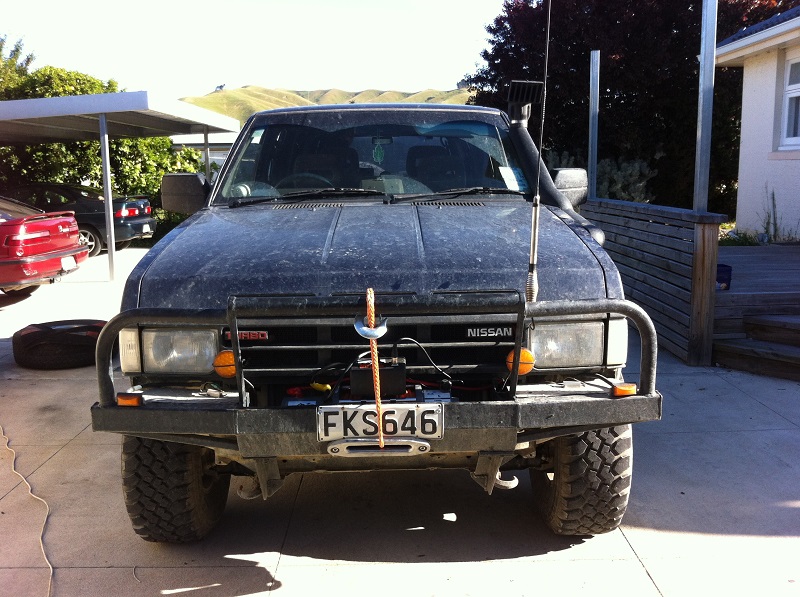

It already had the body lift and 31s on it

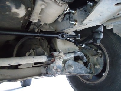

It looks somthing like this now.

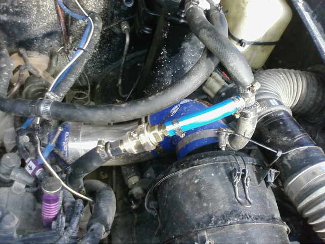

The mods ive done so far are:
3inch intake with custom pod filter housing
Airflow Snorkel
2.5 inch turbo down pipe
EGR totally removed including the intake butterfly housing
16psi (ish) boost
More fuel
32x11.5x15 Maxxis Buckshots
PRS and CB Radios
Big sound system
L.E.D lights everywhere
Please dont hesitate to ask if you want me to elaborate on anything

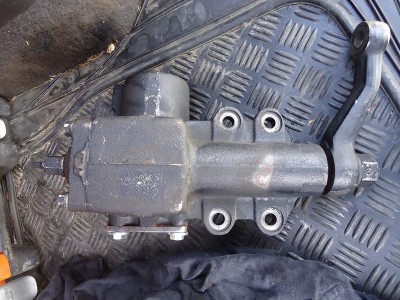

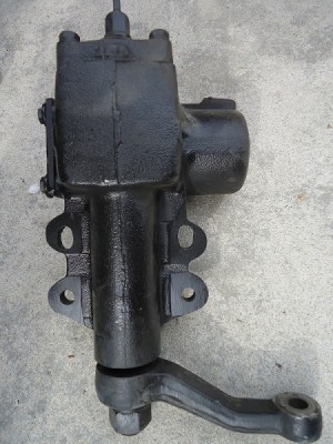

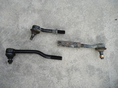

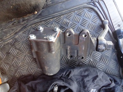

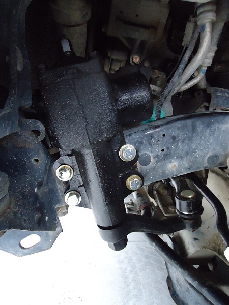

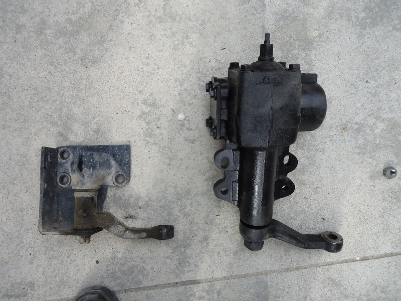

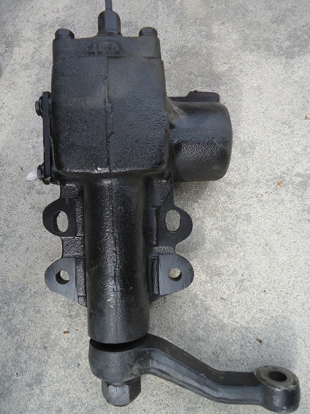

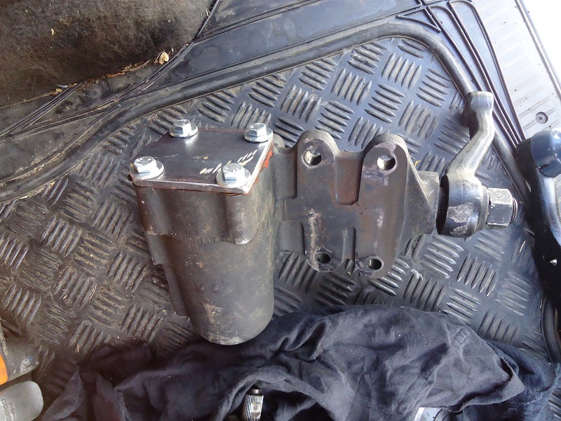

So the next item to add will be the heavy duty/2wd steering system

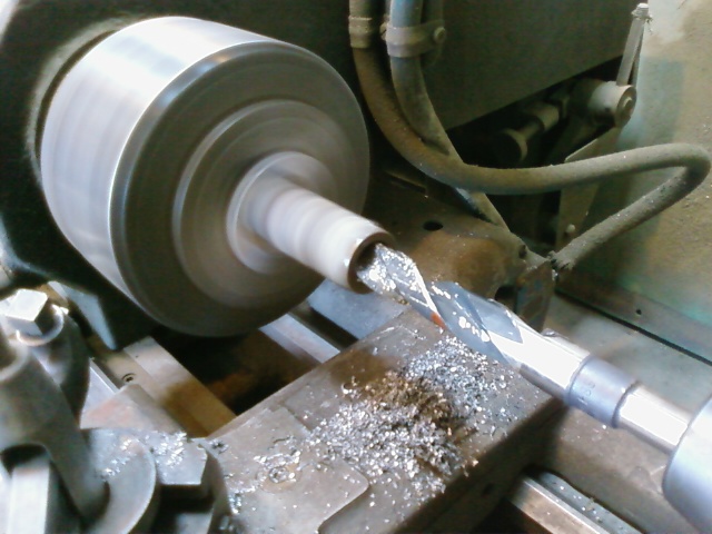

I got myself a second hand steering box (cheers passengerpete) and proceeded to turn it into an idler arm.
I removed the worm drive and piston.
Then removed the pitman arm, rotated it 180 degrees and refitted.
Made a cover plate and filled it with oil.
Very easy to do, only took about half an hour
Will fit it to the truck when the other steering bits arive
