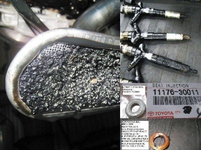

The main problem the later engines had was the injector seat seals would leak causing combustion gas to blow into the rocker cover putting sludge into the oil which can then block the oil pick up in the sump.
So I would look for one that has been well serviced. Possibly had new injectors with new seat seals. Then keep it serviced with correct oil. I would also add a pre filter to the Toyota fuel filter if it hasn't already
The cost of injectors and pump etc will be similar to doing a head on an earlier 1kz.
Here is a photo of blocked oil pick up. As a result you need to replace whole engine
Blocked oil pickup caused by leaking injector seal
http://www.newhilux.net/ridepics/grogfrog/grogfrogD4D-6%20Oil%20Pickup%20Screen%20on%20verge%20of%20total%20blockage%20and%20Oil%20starvationb.jpg
Cant see link.. :shock:

Thanks for the info so far, that blocked oil pickup looks nasty,

evolution02 wrote:Find some of each model and take them for a drive. I bet you'll be hooked on the later model with the 1kd common rail engine.
They have heaps more power and heaps better fuel economy than the 1kz
Yea, those copper washers are shit. The silver ones are much better, we fit those at each 45km service. and every aug08 onwards truck has them from factory.
