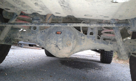

HG46 is combination axle code. HG designates the rear axle as an H233B. 46 designates the gear ratios as 4.625:1
This one has some variation. Pre-2000 versions are the H233B axle with 4.625:1 gearing (31 spline axles). 2000+ is the H233B axle with 4.636:1 gearing (33 spline axles)
It is usually mated to an R200 front diff.
Re: Rear Diff Info Needed - HG46
C200 and H233 diffs both run the same clutch plates in their LSD so won't matter if you do get it wrong. But the 46 refers to the ratio - and if it has a removable cover plate is is a C200, if it doesn't it will be an H233 (this diff is also bigger).
Yep and the numerical part indicates ring gear size in mm - C200 200mm (8"), H233 233mm (9.25")
fullthrottle if this is still the stern of your truck, its an H233. AFAIK the C200 was discontinued on the WD21 platform in 1990 when the first TD27 turbos came out, but continues to remain in use in the latest Navara/Frontier/Xterra.
IMO the H233 is kind of an overkill in a compact truck, the entire axle assembly weighs in close to half a ton.
