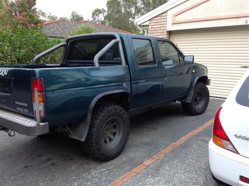

I was thinking about putting in the qd32. but ahh feck it. Time for a new car so here it is in all its not glory
It was for sale for 4000 and I got the guy down to 1400 lol

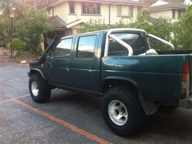

So today I did a body lift on the cab of the truck. I will do the back this weekend.
The snorkel is going and I hve the terrano guards all painted up and ready to go on. Then qd32 turbo big gearbox.
I have pathfinder door for it to give it full size windows as they look heaps better

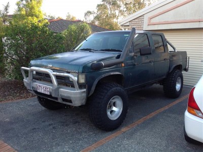

Well I was driving around with out a bull bar and was a tad concerned about what the police might think if they saw it. So any way I fitted my new bar it needs a bit of modification to get the extra inch into it but im pretty happy.

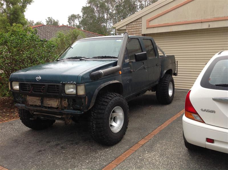

The snorkel is going and I have most of the front panels painted except the drivers door and the bonnet. I will then do the rear doors , tray and roof. Pretty much all done then.

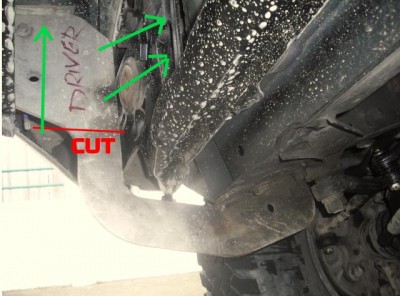

Thx but was more thinking about wax's TJM/Aussie bumper as I have one similar, thinking about mounting directly to the frame through the bumper slots instead of the big long mounts they come with. Not thinking about a winch here.

Well front bar is lifted.
I just clamped it up and welded it to the old brackets.
Easy stuff. Also put my r/f aerial down there. I thought it looked kinda cool.

I'd be doing that ASAP but I'm worried because mine is a winch compatible TJM (have to buy the cradle seperately). But I don't know what the cradle looks like or how it marries with the brackets/chassis. Once I start cutting theres no turning back, I like the idea of a certified bolt-in winch frame
I'm about 90% there on pulling out the grinder because the approach is horrible. What do u think?

So are you thinking about not running the bottom bracket ??
Re: The navara terrano morph
Yeah xactly, then stitch some brackets on where the green lines are thru the slots, based on factory brackets. Yours has lower brackets?
Yes mine does have the lower brackets hooked up
Actually it doesnt have the top brackets hooked up at the moment I will do that this week

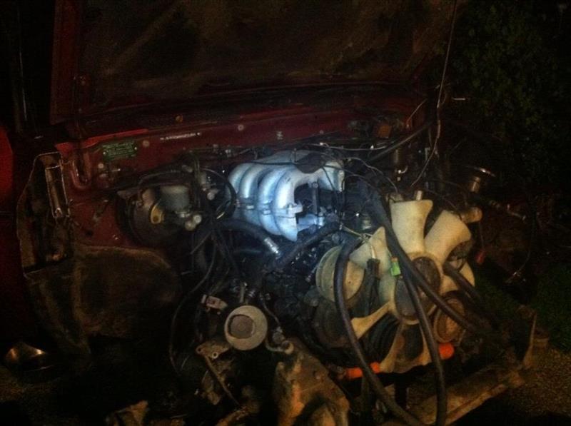

Well the terrano is getting stripped and it was easy to cut the front off instead of taking the motor out. So well this is the poor car now
