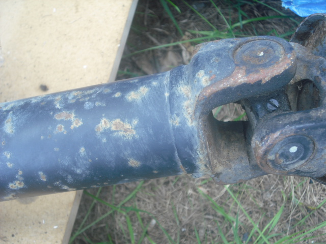

lax2wlg
Posts: 1437
Location: Various areas
Re: UJs no grease zerk?
Post by lax2wlg »
I think I found it
Dirtydog
Posts: 1788
Location: Gore, Southland
Post by Dirtydog »
mine are in the middle of the cross peice, facing towards the driveshaft itself :?
slide
Posts: 895
Post by slide »
Thats the one :D
Whip 'em out, check thread, find zerk to suit, wizz that in there and bingo- greaseable joint 8) .
Sounds easy when put like that ae?
Dirtydog- you'll prob have to remove shaft, move universal to largest angle it can go on so you can get to it, then fit a 90deg elbow type zerk to allow easy greasing when refitted
