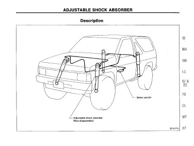

Took my d21 out last night to drop a welder off and noticed the light on the shock absorber button had gone out and no effect when it is flicked between sport and comfort.
Its really really spongy now.
Any ideas were to start looking?

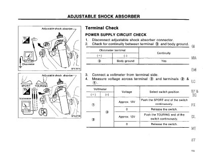

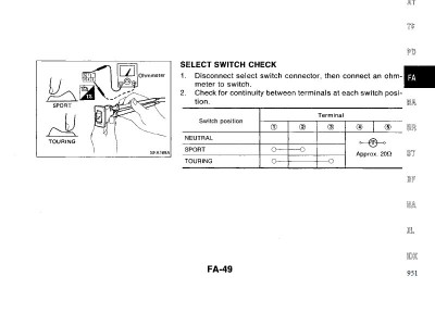

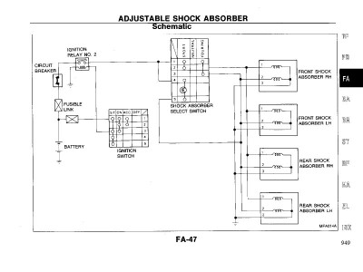

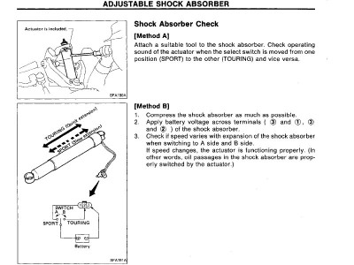

First system i disable when doing a D21. There are some tests that can be done in the manual to check the system or the shocks themselves.
sibainmud wrote:Thanks for that, Josh. Saves me trawling through manual, re-sizing, uploading and linking![]()
