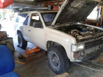

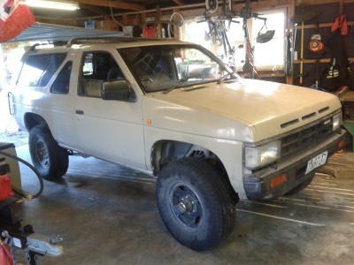

Another Terrano lifted this afternoon.

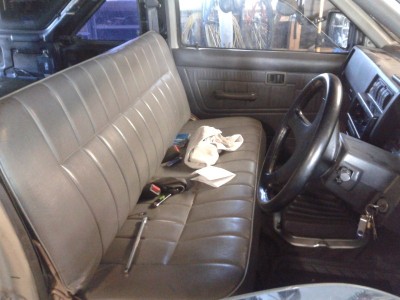

I'm liking the bench seat idea
Re: 22nd - 24th March 2013
how hards the bench seat conversion? i know where i can find one cheap...

Dirtydog wrote:how hards the bench seat conversion? i know where i can find one cheap...
You will have to ask lax2wlg, it's his truck.
It would need to be adjustable though and I have no idea on cert issues. But was cool to see, memories of cruzing in the Kingswood

Finally got my front diff removed, and a r200a up where it used to sit. Unfortunately no photos as forgot to take camera
, but its a squeeze.
Had to space up LH engine mount approx 10mm to give sump clearance.
Time will tell if thats enough.
Big thanks to Sibainmud for chat, yep makes it much easier to cut out those bolts to remove subframe (ya might even say makes it possible

You're most welcome Nath. I would almost considered to be an expert on D21 front diff removal and fitment

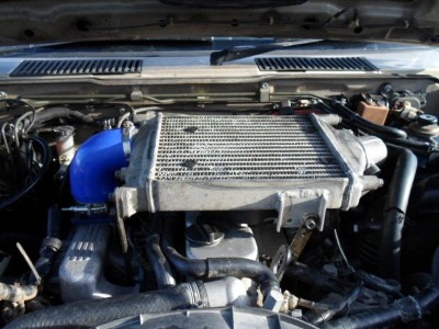

Fitted fan to intercooler
also replaced the 76mm - 70mm silicone elbow that split. Gave radiator a bloody good flush, amazed how much crap came out !

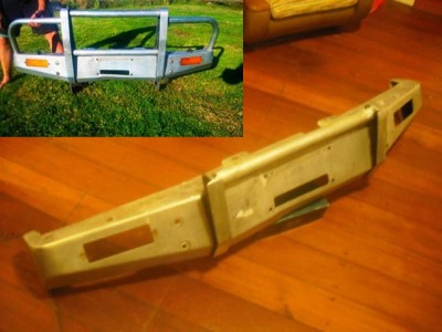

Bathed in aluminium filings
Now for paint...
