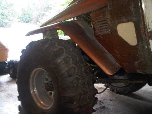

Depending on how much room you need... I removed the 2 upper guard panels completely,
The guard will sit higher and further forward so I also trimmed the front of the guards back to line up with the front panel.
And cut ends off each of the upper guard panels to fill the gaps.
Didn't need to change the front panel at all other than a couple of new holes drilled to mount the guard up.
You will also need to lengthen the metal bracket the guards rest on - or make a new mount on the chassis to bolt them to.
The back of the guard will be higher if you do this and are planning on matching up the steps under the doors (could just trim body under the doors to match).
And finished product:
