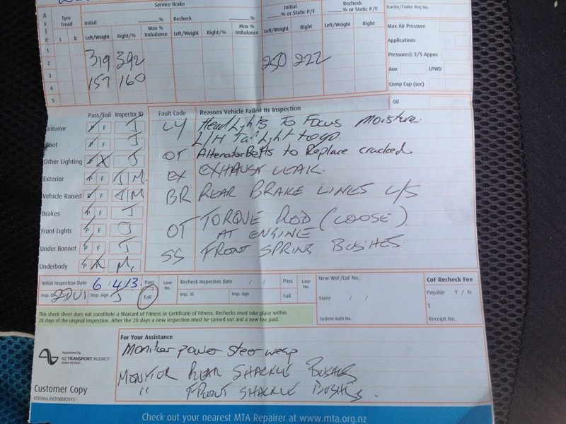

Hi guys just got my 1st ever 4WD Toyota Hilux LN106
have a few things to sort for a wof , apart of getting the truck was to take a hands on approach to repairs.
laugh all you want but i have no idea what to tighten .... , can someone provide a link to an image of this rod and or instructions on how to tighten :)
also are shackle bushes and spring bushes the same thing ?
WOF says Front spring bushes and Rear Shackle bushes ?

Yes thats the torque rod, goes from the top of your front diff to the chassis under the engine drivers side, it's job is to stop the diff housing rotating when you hit the brakes, if the torque rod is loose or worse removed, it creates steering pulling when braking.
The spring bushes and shackle bushes are all the same size and you can buy them as a set, if one or two are shot the rest will be on the way out so replace them all.
What part of the country are you?

Never hear of failing a wof for cracked alternator belts,
wouldn't have thought that would be a wof issue.

because a diesel alternator does the vacuum as well. and if it fails it means crap brakes without vacuum assist.

The torque rod should be an easy fix, from memory its a 22 or 24mm bolt into a captive nut, so it should just need a few turns to tighten it - but as Hosehustler said, it stops brake-steer and if it comes off you will veer off the road every time you brake... I drove mine with the torque rod removed for a bit and its scary as hell braking at speed.

Cheers All , Went and seen Trucked today, Fantastic bloke !
Got the Bushes all done and learnt how to change them , also got the exhaust all welded up :) The torque rod sorted and got some great advice, even learnt how to drop the back seat down to find the jack HaHa :)
Tomorrows mission is to remove and oven the headlights..
Hope to take for Re inspection next Sat, after i get the belts on and bulb in the taillight.

PASSED WOF !
