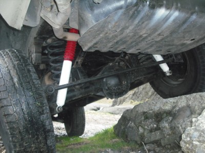

On my Rancho 5000s:
Slip it over, notched end first, its very flexible material and can be manipulated easily.
The notched end fits over the shock absorber body and is secured with the cable tie they provide. The moulded end seats on the lip just below the T-piece.
EDIT: 5000s dont have that T-piece, but that thermoplastic material is STRETCHY
