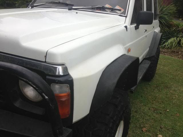

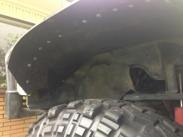

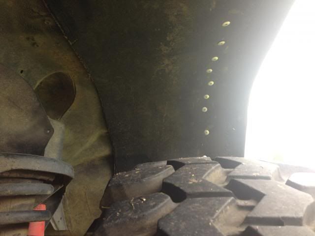

Post by 92 safari 17 »
I used 8mm think conveyor belt from HCD flow technology in Hamilton that was 450mm wide dose my flears and inner gards works a treat and looks mint as well.

92 safari 17
Posts: 220
Location: Otorohanga, Waikato
Re: Flares- conveyor rubber or similar
Heres mine, got it at $10 a meter as it was secound hand.
