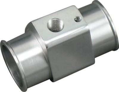

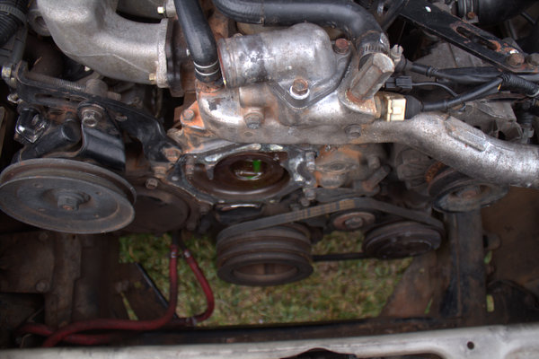

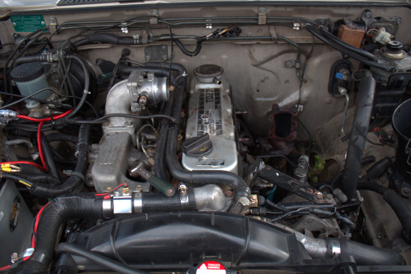

Nice, whats the aluminum part with wires coming off it in your top radiator hose?

Water Temperature adapter, I wanted an aftermarket Saas water temperature gauge and did not have anywhere to put the sender.

Ah, very tidy. Spose you could put fan switch in there as well.

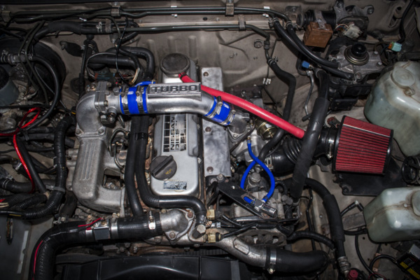

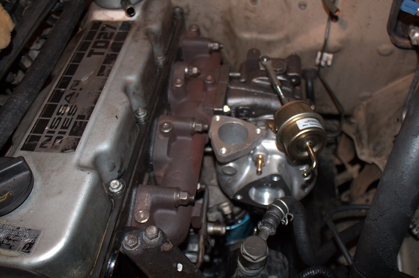

travis2ninja wrote:New turbo off the QD32 engine, Removed EGR.
I have started hunting down an intercooler but have not found one yet.

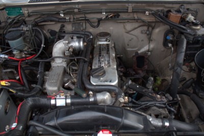

Turbo appears to be a stock one in pics? qd32 compressor pipes are usually moulded rather than flanged ?
Would be a good scheme to fit in a EGT gauge if you planning on tweaking fuel for more power. Or even if you drive it hard, tow etc

slide wrote:Turbo appears to be a stock one in pics? qd32 compressor pipes are usually moulded rather than flanged ?
Nath
I couldn't really have my car of the road for long so i found one with the same flanges, I was planning on installing an EGT gauge but didn't have enough money at the time.
It goes pretty good at the moment for a 2.7l diesel, goes through soft sand fine even with standard AT tyres

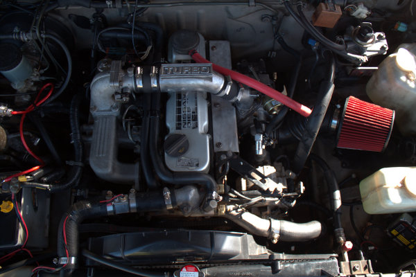

Just a suggestion, disconnect that red hose from the intake and put it into a catch can. It will only start making an oily mess of your nice clean turbo, intake, and intercooler when you fit one.
- travis2ninja
- Posts: 145
- Joined: Sat Mar 23, 2013 2:33 am
- Location: Albany AU
Re: My Terrano
kbjj wrote:Just a suggestion, disconnect that red hose from the intake and put it into a catch can. It will only start making an oily mess of your nice clean turbo, intake, and intercooler when you fit one.
It already has made an oil mess. I have an oil catch can on its way from china. Haven't received it yet, Its a 880ml Dspec one for $32
Re: My Terrano
Or directly into the frame rail, keeps the rust at bay

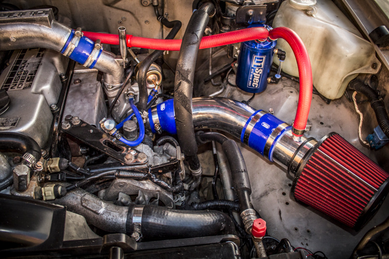

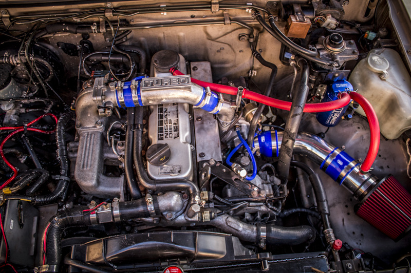

Made up my 3" intake and installed an oil catch can.
My next step is for a 2.5" Exhaust.
Does anyone know where you can get a larger dump pipe? or will i have to make one?
Also does anyone have a list of lengths and bends for the exhaust?
Just to make it easier, if not after work i'll have to get under it and measure them all.

Hey mate,
I've just about finished a dump pipe for my WD21. Search for my post with the exhaust flange diagram. They can also be bought from Autobend for $50 or so. I'll post some pics in the next few days of the divorced wastegate dump pipe I've built - just needs a few more welds.
If you have a trade contact in the automotive industry that deals with Autobend, you can't beat their 2.5" mandrel bent system for under $600. It's in their 'Rage' catalogue. At retail it's about $800 or so, which you 'might' do cheaper custom for similar end result. Easy to install, though brackets needed some minor adjustments, and tail pipe was a little too close to body causing rub at (shaky) idle and over bumps.
