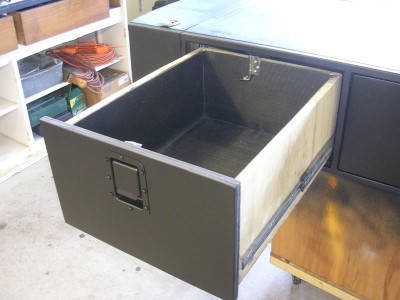

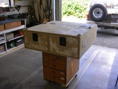

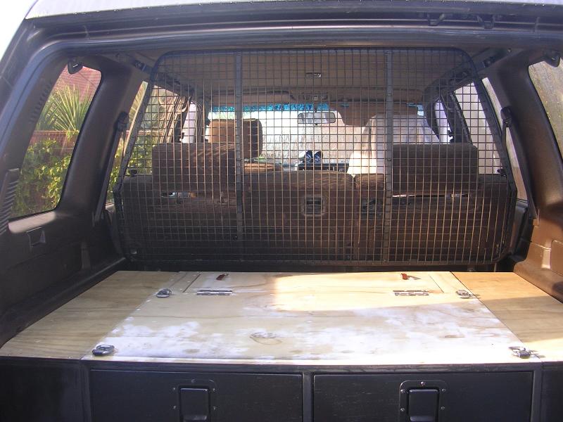

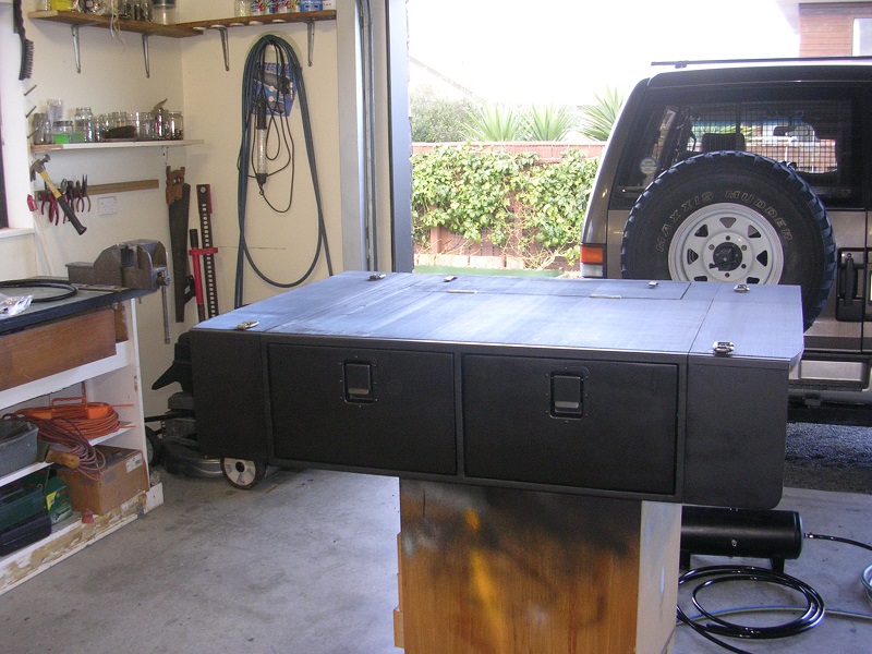

I searched ih8mud and the Aussie 4wd forum and looked at what everyone else had done and then drew up some plans for my own set to go into my Isuzu.
I went with two drawers and a rear compartment. The unit is as high as the rear seats folded down so I still have a flat load area. Could put a matress on top and sleep in there if necesary.
They are about 900x900 and I have a set of wings that bolt on to the sides so they go the full width of the truck so about 1300x900. The wings have to be bolt on as the rear door opening is tapered and wouldn't be able to fit them through otherwise.

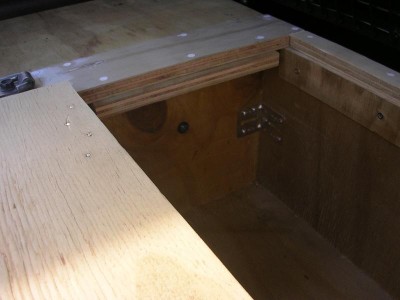

I used 17mm C/D treated construction ply, screws and glue and angle brackets to put it together and provide additional corner strength. The drawers have 45kg ball bearing runners with large metal slam latches to open/shut and lockout latches to hold them fully extended. The runners allow the draws to be easily lifted out.
The top has four ties downs fitted so I can still secure additional stuff on top of the drawers. The rear compartment uses leather straps for handles so the are flush and standard cupboard latches to hold them closed.
I have four d rings one at each corner of the unit and use turnbuckles to secure the unit to the factory tie downs in the back of the truck. Takes about 10 mins to lift the drawers in, tighten turnbuckles and bolt on the side wings.
I am going to line the drawers and the top with either rubber or carpet to provide a non slip surface and stop gear rattling etc. All up I think the total weight is about 50kg.
I used two sheets of ply and laid them on top of each other so when I cut one piece I got two. Ensured that everything was the same size. I just used the skill saw and a large metal level and two clamps to make sure my cuts were straight.
Plan to leave spare parts in rear compartment and one drawer for tools and the other for recovery gear.
Took me about two weeks working here and there to get them built. Total cost will be about $450 once they are lined and finished. Will post some pics up if anyone is interested.

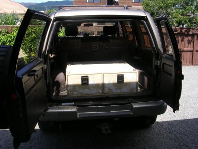

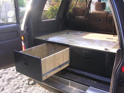

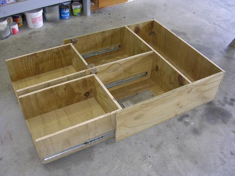

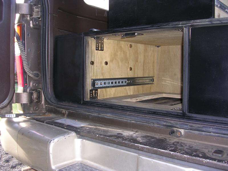

OK no one showed interest but here are pics anyway
I don't have any with the wings bolted on and haven't covered or lined the drawers yet.
Any questions just ask.

My drawers just touch the wheel arches and have cover panels that go over the top so they are full width. I will take some pics with the panels in place so its a bit easier to understand.
Only takes about 10 minutes tops to remove. Remove the drawers then undo the 6 bolts holding the top side panels on and remove those, the undo the four turnbuckles holding the enclosure in and then lift it out.
If I make another set again I would make the drawers out of 10mm to save some weight and use flush mount tie downs on the top.

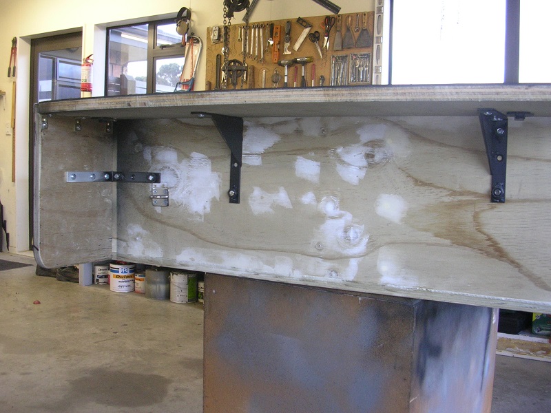

Couple more pics showing how the side wings bolt on and the slam latches and retention pin striker plates.

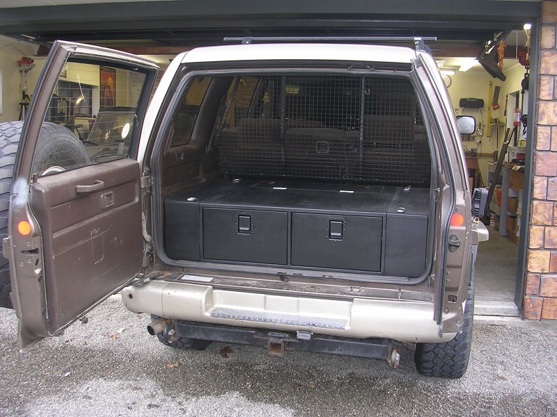

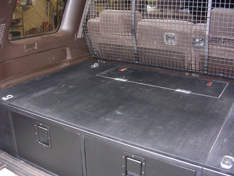

Finally finished my drawers a few weeks ago so thought I would post up some more pics of them finished and installed.
Pretty happy with them, few things I would do differently next time though but these will do for now! All up cost about $500 which is more than I originally wanted to spend but a lot less than the $1500-2000 you pay for bought ones.
Moved the tie downs on the top out onto the wings. Finished the wings with strong brackets with captive nuts that bolt through from the inside of the drawers.
Lined all the drawers and the top with 3mm rubber and fitted a 1.5mm metal angle across the top to protect the edge and then painted the front faces.
