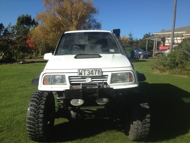

After looking and looking for a new truck i finally bought a wee escudo, Most of the hard stuff has already been done so the plan is to tidy it up and get it running the way i want :wink:
Basic run down of truck
3.8 holden v6
safari diffs
coil suspension
5 link front
4 link rear
35s the list goes on...

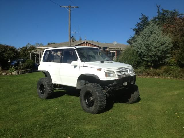

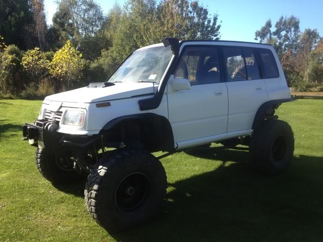

How it looked when i picked it up last Tuesday night
Firstly i fixed up the bonnet, someone had put a bonnet scoop on then replaced it with a sheet of tin so i slapped a new one on

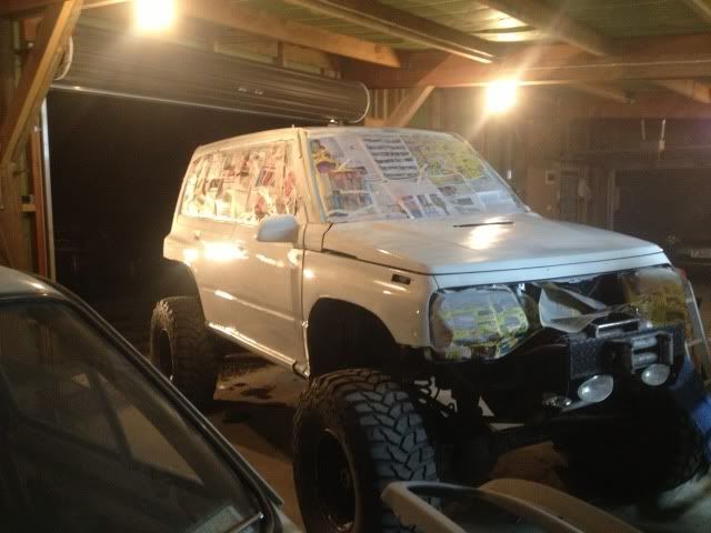

Next i stripped it down and gave her a paint...
Thats all for now, only owed it for a week so making good progress so far :lol:

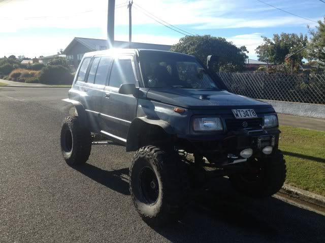

not a very productive weekend, managed to to do one important job.... a working stereo :lol:

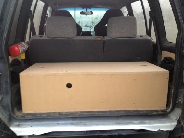

Also mad up a box in the back to hold the dual batterys, air compressor, air tank and a few other wee bits and bobs,

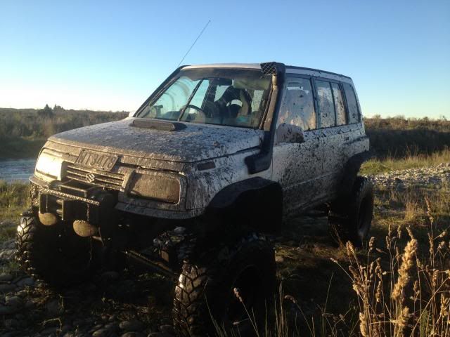

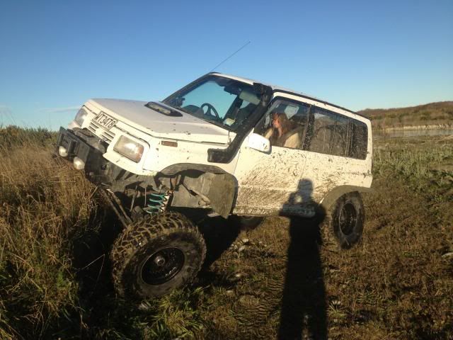

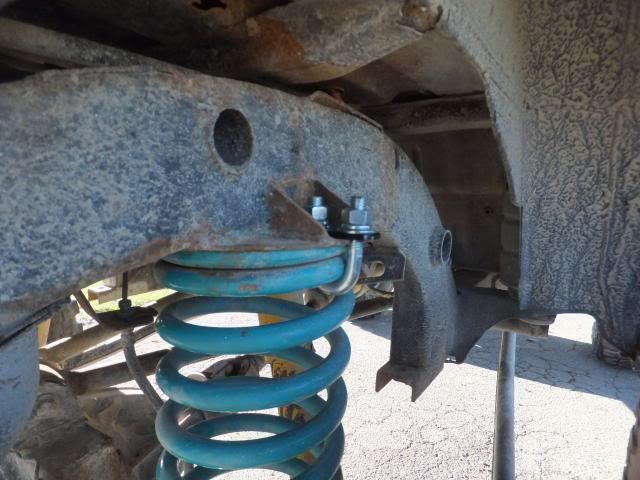

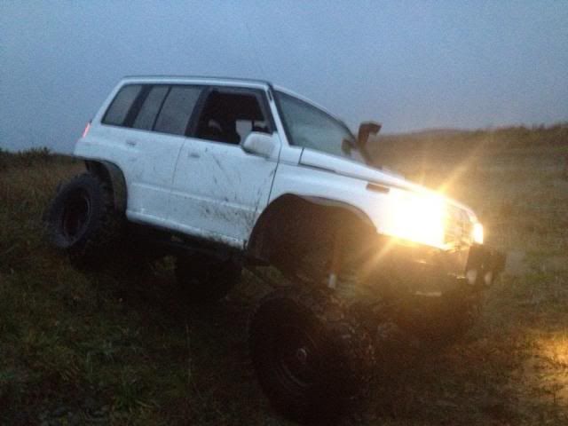

Also manged to get out for a wee play, next job will be to make the springs captive cause they keep falling out :roll: going to make some sort of clamp to hold them in place, oh and a wee flex shot :mrgreen:

will one of those fabric straps work to stop the springs falling out?
i was thinking about using them..
Mr Zuk
Posts: 222
Joined: Sat Apr 16, 2011 9:56 pm
Location: Oamaru
Re: Zuk monster Tidy up
Post by Mr Zuk »
PLAYUP wrote:will one of those fabric straps work to stop the springs falling out?
Possibly would but im thinking about using something more robust, maybe along the lines of an exhaust clamp or making something similar

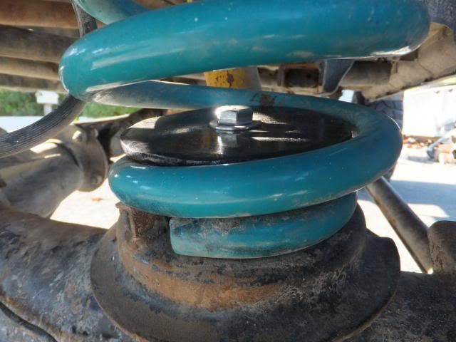

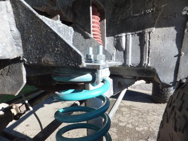

Got my springs all sorted out this weekend, they no longer fall out :mrgreen:
have U bolts top and bottom on front springs and U bots top of the rear and flat plates at the bottom
