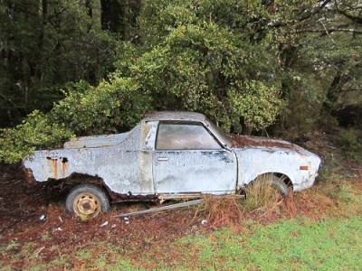

we got a few of them at our batch on the west coast well should i say we got a few half's of them. Most still run though even with no floors
one of the better ones
