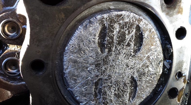

had my 350 freshly rebuilt ,new pistons, rings etc the whole lot, new cam manifold carb, everything... all done at a engine building shop in town. with a pretty price tag too
now last week we dropped it in my hilux, fabbed up an exhaust and ran the cam in... all went well was starting sweet and and that, drove it round the yard a couple times, and it was stil starting and running perfectly, absolutely no issues, so on sunday evening I drove it home and as I was driving, it suddenly lost power, made a loud ticking noise and backfired and spluttered to a stop,
so today since I had the day off I pulled the plugs out and number 2 and 8 were all smashed up...
so off came the heads and I found 5 pistons were buggered, the top skirt was cracked on some and completely gone on others leaving the top ring loose too smash around the bore. now im wondering y it all happened at once and y it happened at all, was it faulty pistons, was it that the engine builder maybe didn't have the ring compressor tight enough when putting in the pistons? I don't know..
Has anyone ever seen this before??
And before I march into the engine builders all angry and accusingly demanding a new rebuild, could this possibly be my fault some how?
What can cause this?
Please help....
Please help....

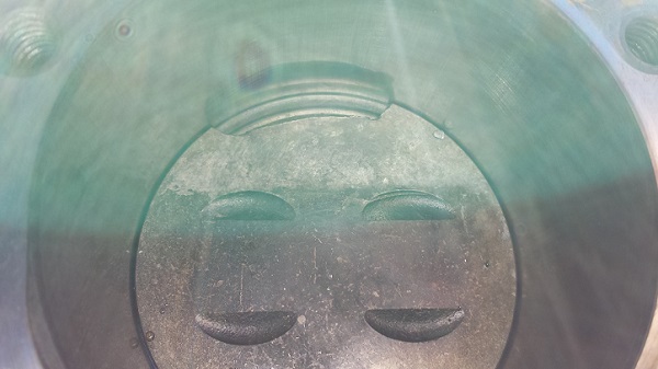

Re: Freshly Rebuilt 350 piston abortion LEFT ME CONFUSED
and a couple more
- Attachments
- 20130602_13014959495949.jpg (54.78 KiB) Viewed 5529 times
Makes me wonder if its had a bit of a seize. Tight new engine and all.
Would definitly be one possible explanation for several pistons to be damaged at once.
Gees mate, that is a rather major.
I'll throw some questions at you...
- In that first picture, is the top of the piston sitting higher than the top of the block?
- When you first ran it were you using some special running in oil?
- Can you turn the crank over by hand and see where those pistons rise to.
- Apart from the smashed spark plugs, what does the rest of the head look like (cylinder for cylinder)
- If you have a parts list, do you know what crank, cam was installed?
- Had the heads plained down or increased the performance with other rockers, cam etc?

fullthrottle wrote:Gees mate, that is a rather major.
nope sits flush.
Yes was running lucas high zinc break in oil as recommened and a high zinc cam running in additive, both supplied from engine builder together.
yeap they all sit flush/ come up to the same height.
yea all the heads look fine minus a few very small dints where bits of piston and plug have been smashed against, on cyl 8. however there was bits of piston all through the ports ...
don't have the parts list anymore as the missus put it thru the wash when I left it in my work pants.. but the crank is stock, and the cam is a 'comp cams' 4wd recommended down low torque cam.
heads were plained a touch but deffintly nothing big, as i wanted to have the choice to run 91 octane, rockers and valve set all standard, they only had a grind or lap in the rebuild.
thanx for your input
