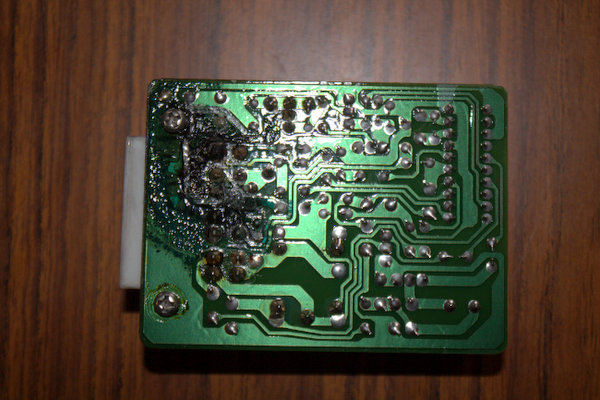

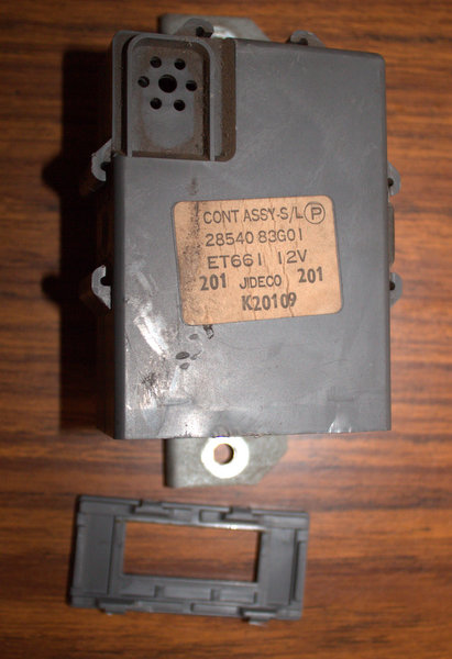

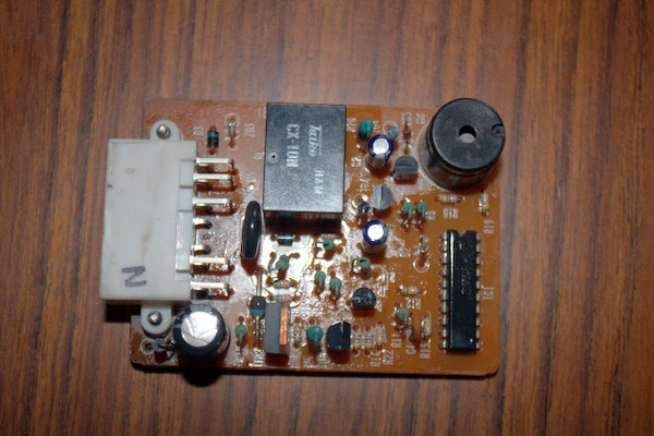

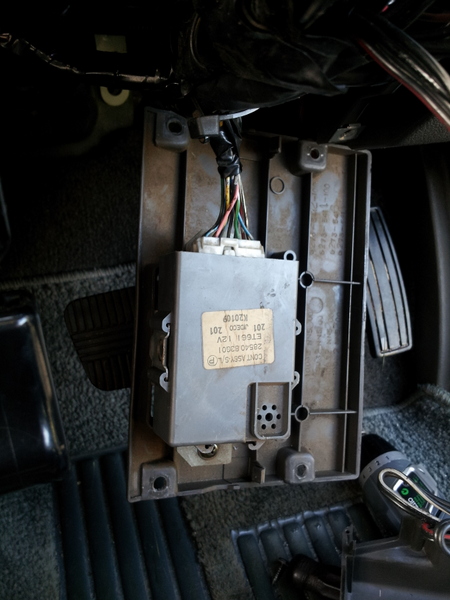

Good News Everyone
After taking the seat out pulling up the carpet following all the wires that little control box is for the Shift lock.
It looked fine and smelt fine (no burnt smell that is).
But decided to open it up and have a look just to make sure, and guess what? Its burnt out
So hopefully when i get a new one it should all work.
Brand new online for $81AUD or tomorrow i'll go to the wreckers and see if they have one for around $20 i presume.
Re: 92 Terrano Auto not shifting out of Park?
As bad as it looks, it may not be all that bad. Looks to me like the solder joints have gone dry (high resistance) where the plug pins are soldered to the board. Have a scratch around there, clean it up and re solder the plug pins. It may still be a goer for you?

- travis2ninja
- Posts: 145
- Joined: Sat Mar 23, 2013 2:33 am
- Location: Albany AU
Cleaned and resoldered and no go, it has melted the board.
