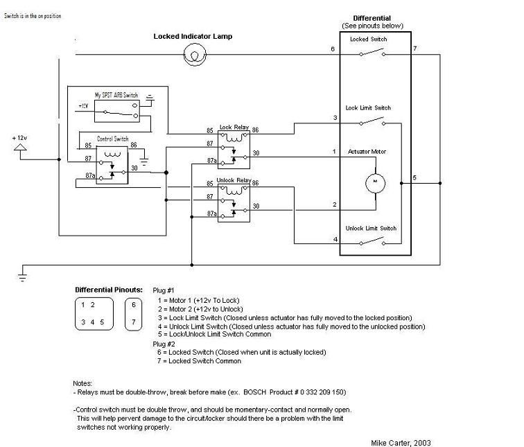

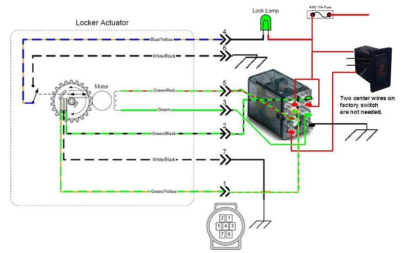

slide
Posts: 895
Re: Prado locked diff
Post by slide »
Here's a couple of wiring diagrams from the net where guys have made their own locker actuator switches. Might help you with identifying wiring
