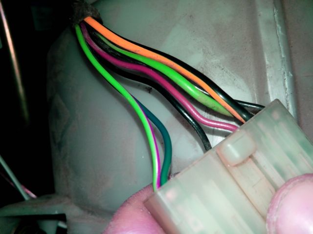

has anyone on here got an aftermarket glow plug timer on there truck ? if so can they please post a picture of how its wired in as i have one but not a clue as to how to wire it in ?

What wires do you have from the box, and any info with it? I can find out what wires you need to use in the truck if I know what you have.

I have just done one with that same unit... The colour codes are written on the back of the unit....Cant recall exact colour codes would have to pull unit from truck...But...One wire to the glow relay, one to earth and one to ign power....Also another goes to the glow light...
And one more is a sense wire for when the engine is cranking...

heres a pic of the loom also the far left wire is green and red not pink like the photo looks and i think theres a brown in there too, its the ecu loom where i have seen other wired into in the past
