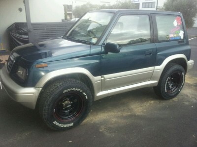

Have started modifying the suki after building up some money.
Brought some 16x7 steel rims
Have grinded 2-3mm of the edges of both front calipers to fit the rims..
i Was told that if you fit 1.6L vitara front hubs to the v6 model you can run 15x7/15x8, but I decide not to go to that effort.
Next thing I need to do it sort out tyres, im looking at some federal couragia one, they seem to have a good tread pattern and look.
Hopefully this weekend I will Sort out a DIY snorkel to fit
I'll upload some pics of my progress
If anyone has advice on what I should do then let me know

I have now got new tyres on the zuki and shes looking good. next task for me to dois set up my snorkel and light bar. i got a 2.5inch lift kit priced up at 1130 so not too bad.

Trucks Looking good.. What size tyre's did you end up going with ?

Hey chairmen. I went with some 245/70/16 hancook dynapro atm. They look gud and are suitable for road and mud as i run them all the time. have my old rims and tires just for fun. When I first got my zuki I brought some Dobinsons springs which gave me around 25mm lift I think. Im just running standard shocks on the rear. hoping to buy a fts 2.5inch lift kit soon to get more lift or make my own custom peices. need more lift so the tyres dont thew on the guards

Finally I manage to get back on here and start posting some more of the work I have carried out on my vitz. Lately I have been to the bombing range alot and wood hill, have found that the tyres tend to rub under the gaurds alot so am starting to sort out my lift.
I have got some 1.25inch spring spacers to put in the rear and am going to order some of bits4vitz for the front. before I fit these I need....
to make an a arm spacer and put a drive shaft spacer in.
Also have just brought some commordore shocks to fit so i will see how it all goes..
Im in the progress of running breather lines from the gbox, T case, front and rear diff to the engine bay, just thought it was a good idea as i started smelling diff oil inside the car from the rear diff breather and got sick of it.
Here are some photos of everything and anything.
hope some of it helps you guys
