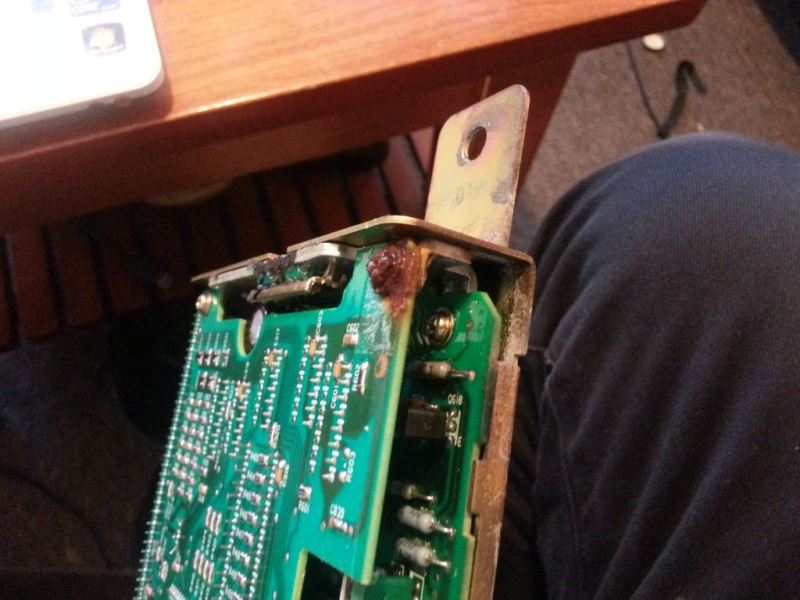

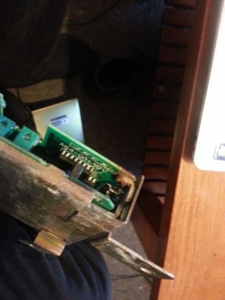

So we finished off the install last night and suprise suprise, this gearbox has the EXACT same issues as the last.
The Problem is that the transmission when in 'D' will only be in second gear, when accelerating away, it has some quite violent lurches. Once you get going, say over 40kmhs the problems aren't quite as visible. When you let of the accelerator and start coasting you can feel small shuddering and the revs slightly spike at each shudder. You can manually shift down into 1st gear, but by itself when in 'D' it will be in second gear and never shift above or below.
I'm at a loss of what to do now really, here's what I think could be possible:
a- The gearbox I bought was stuffed, and either the guy who I bought it off lied to my face or it failed after install, in the EXACT same way as the last??
b- There's some electrical problem with it and I was given poor advice to pull the gearbox.
Has anyone got any other Ideas regarding what it could be? Where is the TCU in a D21 and how much control does it has over the transmission?
Thanks for all your help

ok, found the Transmission control unit, its right behind the the driver side rear speaker. Very strange location.
Anyway, I definetly think it could be the culprit, the box had visible corrosion in one corner, and one a few drops of water came out of that corner whilst I was undoing the case. Got a new one coming up, hopefully monday! Take a look and see what you think...

Its not a bad place to keep it in my opinion, keeps it out of the water (aslong as you have no leaks....)
