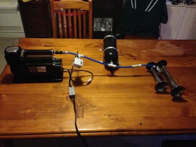

tow99 wrote:put the handle back into the fire extingisher but remove the valve.poke the compressor outlet up the hose of the extingisher and remove the gauge or fill port which you should be able to get standard air fittings to fit to run the line to your horn and t a line off for your pressure switch.works good!ask willie if he remembers the air horn i had in my familia when he was back in wellington.i blasted him pretty good one day
Cheers mate. I asked Willie if he knows a tow99 but it's got him stumped.
Anyway.
Got all the parts together and working today. Fit it tomorrow.
I've got it setup so I can unplug the 45amp power wire from the truck and plug in the extension lead to the aligator clips, meaning I can still use the portable compressor for what I brought it for. I can also unplug the pressure regulating switch from it too.
Had the pressure set at just 50psi and those horns might not look much, but man, they do the job.
