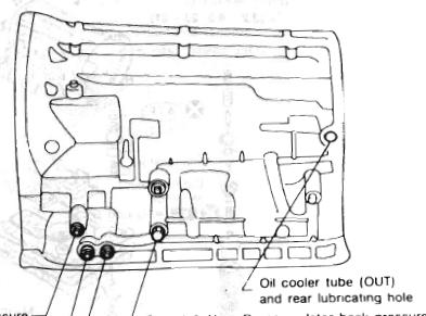

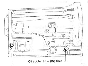

I am wanting to install a trans temp gauge, which way does the fluid flow from?
Thanks

Re: Quick Question on Which Transmission pipe is Which
Posted: Tue Aug 13, 2013 5:21 pm
by fullthrottle
You want to connect it to the 2nd pipe as this is the oil outlet from the trans which will show the true oil temp as it exits the trans.
