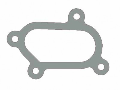

Hey guys
I've drawn this from a bunch of dimensions I was given.
But...can anyone check a dxf against the actual turbo (or factory dump pipe)??
I've only got my daily driver to use and for now that's in the too hard basket.

Yup I can, if my old dump pipe is still under the house....
I have printed out the file above with no scaling.(if its to scale?)..Will check it tomorrow.
Otherwise your best bet is to buy the gasket....You will need a new one if you plan to disturb the pipe later for your dump pipe...

The jpg above is not to scale...was only for a thumbnail.
I can send you dxf if you can work with it.

2MEKE wrote:The jpg above is not to scale...was only for a thumbnail.
Don't think I can work with a dxf file...No Cad on my PC's
What about a to scale pdf or jpg file?? The Cad software should be able to output to a printer...

Seems that pdf's are not allowed as attachments.
If you PM your email I'll send you a 1:1 pdf.
