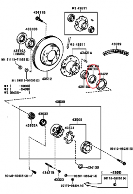

Ive brought a terrain tamer rebuild kit and it didnt include the outter seal (circled in red in following pic). i know the tt kits suit the aussie trucks. is this still needed as im not running the electric engagement side now as, as far as i can tell its only need for that?
