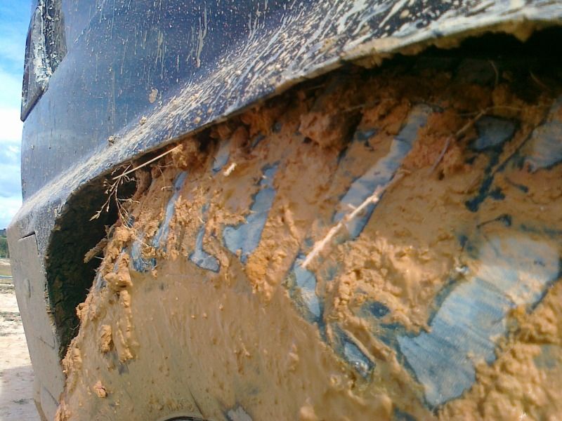

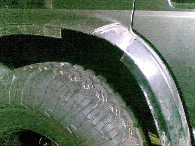

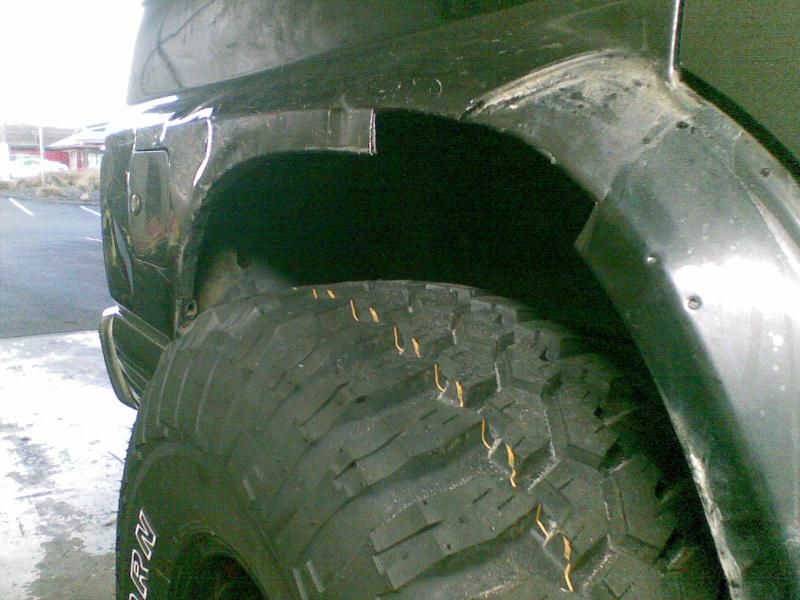

Re: Next step for the Safari. Advice wanted.
I Cut many small slits , then bashed them in / fold them with a hammer .. If I was to do it again, less slits, and more hammer .
the more cuts , the easier it was to fold, and less paint damage
( Silly me back then) .
Used an Air saw, because it's what I had at the time .

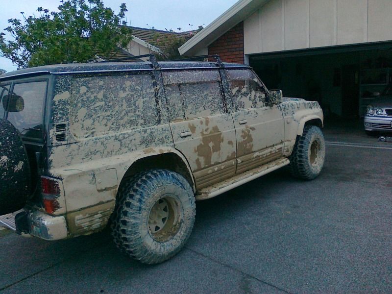

LWB with 33's , factory height , and that tyre being close to the gaurd.
Factory bump stops
any more it would rub . I have thought about lowering the rear bump stops maybe 10mm , because I do get a tyre rub inside the rear gaurd once in a while, (too small to worry about ).
Front was much easier, Just cut the gaurd, single skin is nice and easy to do.

Thanks Camel, im guessing the first pic is at full flex? Looks good.
I was having a look at the patrol forum (ausie) thats exactly how they are doing it and using vice grips with the big flat nose to bend the guard in, gives it a nice neat look and can still fit flares ( For WOF Purposes). Looks like you running 10" rims so I should be able to squeeze my 8" in there.
Just one more Q, how much did you "Fold" in. ie. How much guard did yo remove/hide? Im guessing for me im going to be looking at about 50mm in the worst places to clear 35's. Ill have to start by borrowing a set of 35's and find out where they will hit.

They are the 15x10 at -44 offset.. Love the offset, Hate the width due to tyres de beading to easy , Running tubes now and has been good . touch wood.
Wouldn't worry about the height from gaurd to center of hub much , espically with Body over Chassis setup . Would need Certing for change of tyres size etc and if you've made any other mods if you want to make it fully legit .
For my "flares" I went to bunnings and got garden edging ,and a bunch on 90digree / L style brackets.. Bolted to gaurd and to garden edging, they are a bit soft, so it will bend bracket before bending the gaurd too much when driving on banks /walls .. Not too worried about that my self .
Flares look crap on the road, but meh Covers the rubber and covers what I've cut out aswell so it's fine for what I want it for.
