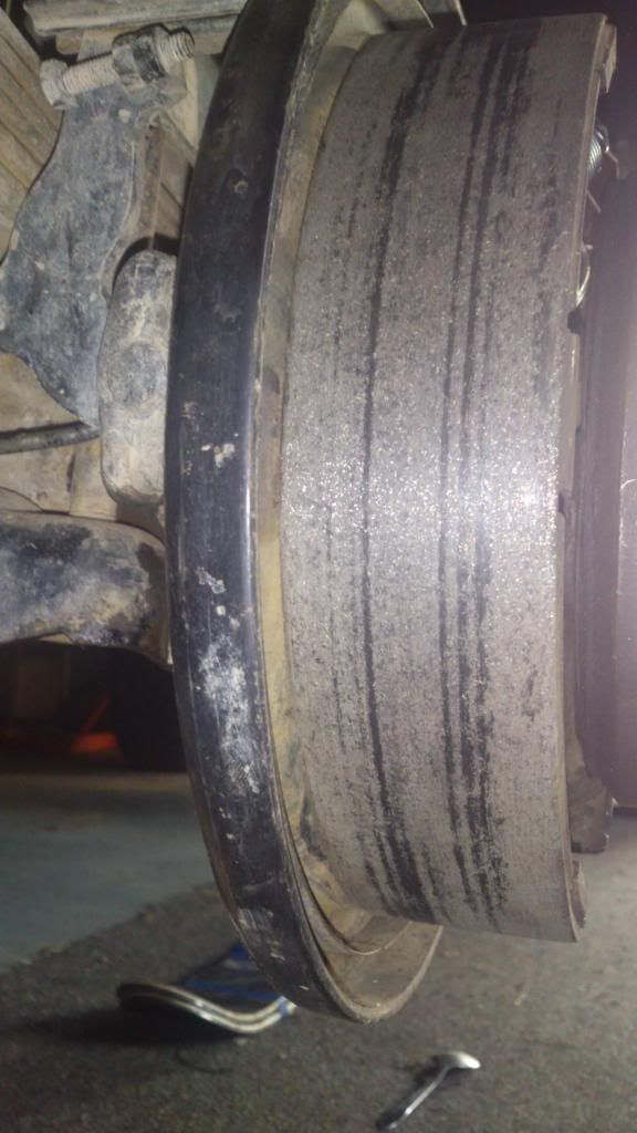

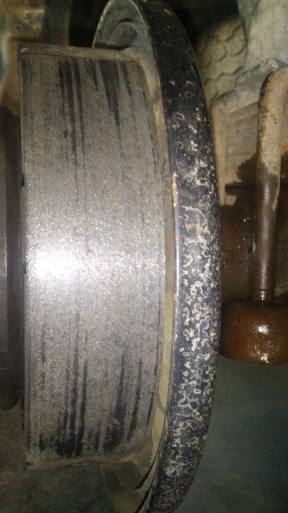

Here are a couple of pics of the side which is testing weaker. Do these pads look like they are wearing as they should? Not a lot of the surface seem sot contact the drum. This was after i sanded the pads and used the brakes for a short burst

Post by Heath »
What does the inside of the drum look like?
Put a straight edge on the braking surface and see if its got any channels or distortion.
Are both sides showing the same wear patterns?
If you swap the drums over does the wear pattern change to the good side?

Looks to me the best option is machining your drums and replacing the shoes I have wasted hours trying to get them even in the past. Your shoes have a section on glazing on them My 2 cents anyway

Yea cheers guys. I might just get the drums machined; fit new shoes and start fresh.
