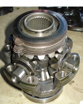

Scruffy wrote:Just in the process of sorting this Safari diff out for it, so it will have 4 wheel disc brakes, and a stronger lsd,
Nice, I didnt realise they had drum rear.
I was reading as the years went on, Nissan clutch LSDs got weaker and weaker (cost reasons). They didnt change the design or housing, they just left out the expensive friction plates. By the early 2000s they were just stuffing spacers in:
So people can add more clutches to restore function pretty safely.
I notice that the Safari H233B rear LSD center is slightly different to the R50 but they are both 33-spline. Saf. LSD has 4-tabs on the clutches whereas R50 has 2-tabs. The 1980s/early 90s Saf. LSDs seem to work exceptionally well without modification.

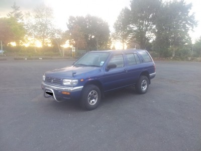

Took a better photo of the Terrano yesterday avo up here at the workshop.
