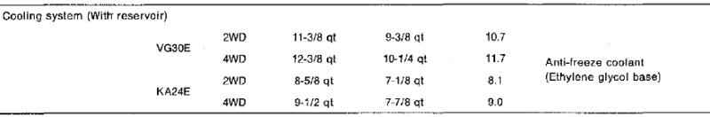

details from the only terrano manual I have,
too bad it doesn't have the TD27, but ya learn to deal with it
