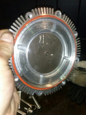

This is really getting to me! all info to sort this outfound here and still no luck help! 90 model import terrano
new radiator
new water pump
new hoses
new coolant
even had the viscous clutch off to day and inspected the oil/silicone all good
now it only gets hot when air con is on or uphills dont have the aircon up hills or the temp gage hits 120 degrees way to quick, so im left with either i need another fan on tje condencer or a head check am i on the right track? the previous owner is positive if i make up/find some of those engine bay guards in the wheel well to the chassis those things it will stop the problem...really? any help would be great!

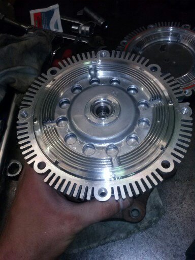

BDR3M wrote:only gets hot when air con is on or uphills dont have the aircon up hills or the temp gage hits 120 degrees way to quick,
Ok so it only does it as above...
My gut feeling is telling me there is not enough air coming thru ...to remove the heat from the radiator.
And the viscous fan is faulty... Just cause its full of silicone doesn't mean its working...
There is a bimetallic spring coil on it which moves the valve around when its hot and changes the amount of fluid it bypasses...
If its broken or jammed up then it may not couple the fan properly...
Normally it will roar rather loud when it kicks in...
My 10 cents worth....

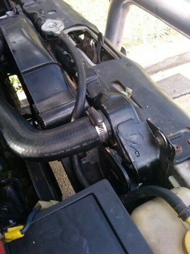

Yep, my money is on the fan too.
I would also check the aircon radiator is not fouled with bugs and other shit as it sits in front of the engine radiator and could be obstructing airflow.
As for radiator shrouds, mine has the bottom section removed since I did the body lift and I have no issues with over heating; well not any more 8)
I know of some who have removed theirs all together and have no issues either. When the fan is working as it should it sucks a power of air.

after a bit of playing around this morning im looking at the fan again on start up its not "roaring" bit annoying as its had 2 water pumps in the last 2 years previous owner said so rad/condencer/transcooler are all clear of muck. will source another pump and fit a extra fan to condencer.
i didnt fit new parts was done before i bought it but had all receits dated no more than 6 months ago.

Post by kbushnz »
Fan wont "roar" until it starts to get hot enough to activate the hub and make the fan do some work...
Mine only does it when air cond on for a while or some serious throttle work...
You can feel the engine load up when it kicks in....

BDR3M wrote:right on start up they engage for maybe 15-20 seconds or is this something iv just noticed on toyotas?
they can engage at start up as the fluid in the hub all drains to the bottom of the hub and when you start the engine the fluid locks the hub for a few seconds until it is pumped out of the hub back into the reservoir.

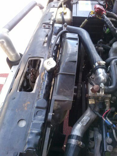

if i took some photos could some of you be able to tell if the parts are a miss match?
kiwipete
Posts: 2328
Re: another overheating terrano
Post by kiwipete »
Post them up on here. :wink:

see if this helps?
