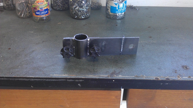

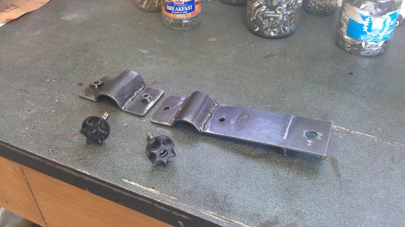

Made up a shovel holder to mount the shovel on the back next to the hilift jack.
Was actually harder than I thought getting it all sitting correctly. It sits a touch higher than I would have initially liked but at the end of the day it's lower than the hilift.
Used some 4mm plate and some tube I had lying around along with two old bed head mounting star screws. There is a brace on the back side to prevent flexing. Just needs a lick of paint now.
