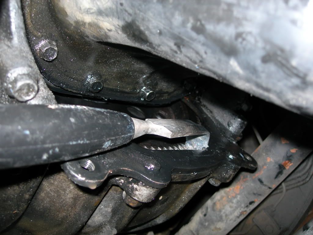

could this leak oil? it seems this the highest poit with oil on it,
http://www.offroadexpress.co.nz/sites/w ... 1415_0.jpg
shit pic i know, but its the best i could do, i think thats the injector wit the 1 on it, there is oil in the nooks and crannys there, no obviose leak spot. could it be a seeping oil leak?
also my theory with the sudden puddle is,
oil has been leaking for some time, and has built up behind the inspection plate in the bellhousing, then when i water blasted the uderside i unblocked it and it ran out, the drip has since slowed to one or two per day now.
i now think that its not the rear main seal but rather the rocker cover seal or head,
oil is running down the back of the egine and through the bellhousing and out the bottom. there is a little hole there for that reason i think, see link.
http://i42.photobucket.com/albums/e344/ ... CN0756.jpg
there the guy has the plate off to jam th fly wheel. you can see the hole in the middle between the bolts,
am i on the right track.
