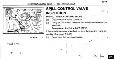

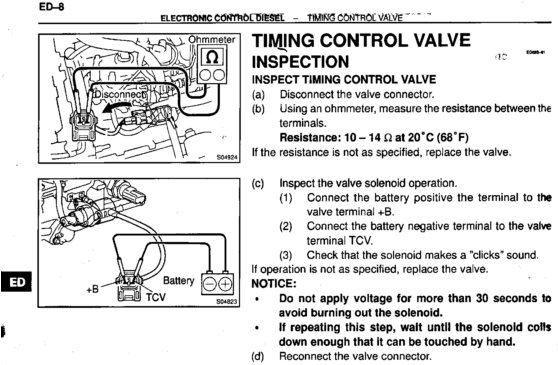

KZJ70 wrote:A/T
I'll check the pump. Thanks for the info. Any way i can check the ECU?
