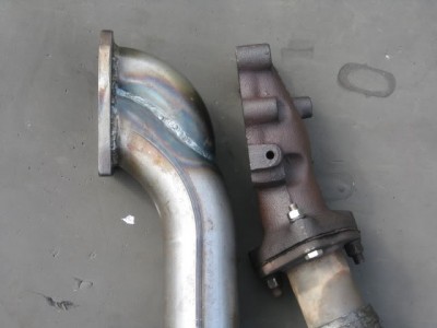

Do the whole dump pipe, not just the bit on the bottom.
Something like this
Factory one's are tiny and restricted as f*%k. Loose the mufflers while you're at it, makes a big difference to how they go

I've just used 2 1/2 inch exhaust tubing and made my own flange by tracing the gasket onto a piece of 8mm flat bar (I think) and had the local muffler shop bend it all up. Also the above pic isn't mine, just one I found lol
