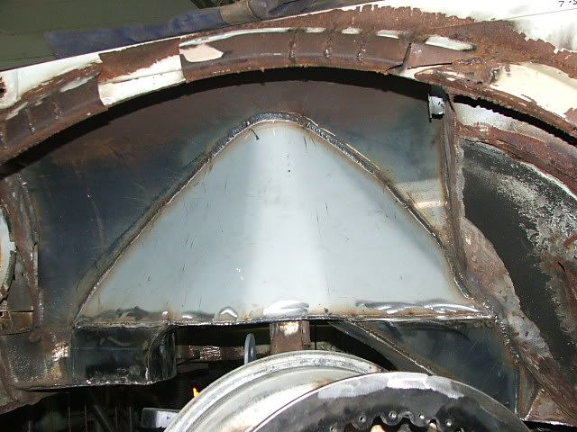

Cheers, I shall do a bit more practice and see how I end up, I might start in a new area today
What sort of amps, volts do you guys use?
I suppose I should have also said im using 0.8 panel.

from what ive read and been told is that co is good with the heavy weld but it will splatter lots more then mixed gas
with 0.6 wire onto 0.8 s/m and using a 175 machine then i would be starting at around 30/40% dropping down to get the flow with the spotting technique.
also you need just enough gas to weld with it should not be blowing out.
with setting the gas start with none and adjust upwards until the weld starts to form as it should then wind it back down until it starts to look and sound like crap, then just a touch more flow, now this is your std start position, if it starts to go bubbly then a touch more again. to much gas and it will affect the weld and you are just wasting money

stick with on off welding or stack the dot, this will allow you to weld easier, the technique has been discribed above, will give you a nice tidy weld
A little tip that will help if you can manage put a fold in the panel so that you double back the edge, so your welding corner to corner, this is a good trick when welding across big panels as it adds a structure that will resist warp or overlap the edges by a mm or two, this will give you a bit more material in the weld to soak up the heat
before you start to weld you want spot welds along the join about an inch apart, this will help control the warpage and keep your material pulling apart

Filthy4x4 wrote:mudlva wrote:are you pushing the weld pool or pulling it?
i pull the weld when on sheet metal as it tends to have a better reaction on keeping the weld thickness up verse pushing the weld, it is also easier to push the wire straight through the sheet creating big arse holes![]()
panel hitters use a product called urethane to stick, seal glue every thing together with, a bit like a builder running around with a tube of salleys all clear silicon at a guess
Pulling the weld seemed alot easier to me. Have created and filled some good holes![]()
So there isnt a magic bog that will actually fill and make water tight?
Maybe I should just mask and urethane a strip down the middle![]()

CO2 does give better penetration but when welding thin sheet over-penetration is usually the issue not under-penetration. Argoshield light is the gas you want for thin sheet.
At the end of the day welding thin sheet steel like that used for vehicle body panels is a skill that only comes with practice. Even very experienced welders sometimes embarrass themselves terribly when faced with an apparently simple rust job on a car.
A tip - When prepping the metal for welding use a DA sander not a sanding disc on an angle grinder as it removes too much material and there is no spare material thickness on vehicle body panels.
There's a number of tricks you can use such as:backing up the weld with a copper backing block (if you can access the rear of the weld), pulse welding etc. I'd recommend you have a look at some of the instructional videos on Youtube until you see something that looks like it will work in your application.

Thanks guys
I actually have some carbond floating around, im trying to weld as much as I can so I dont have to bog much
well thats how the theory goes anyway...
Im slowly getting the hang of it.... I think. New reg and argoshield light made a big difference.
