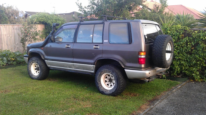

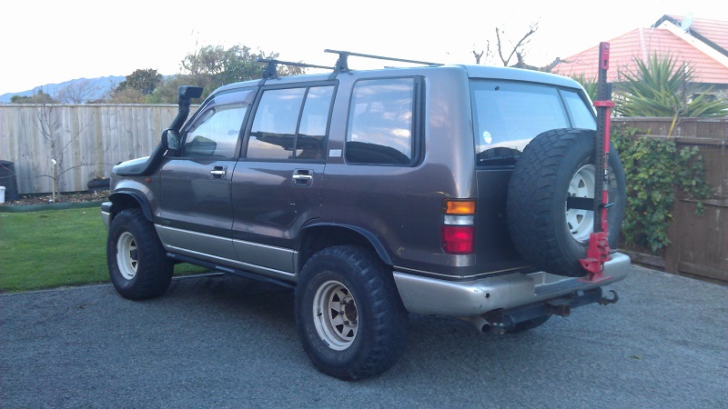

Not sure if the difference is visible in these pics.
After with spacers and springs
Before with 2in OME springs
