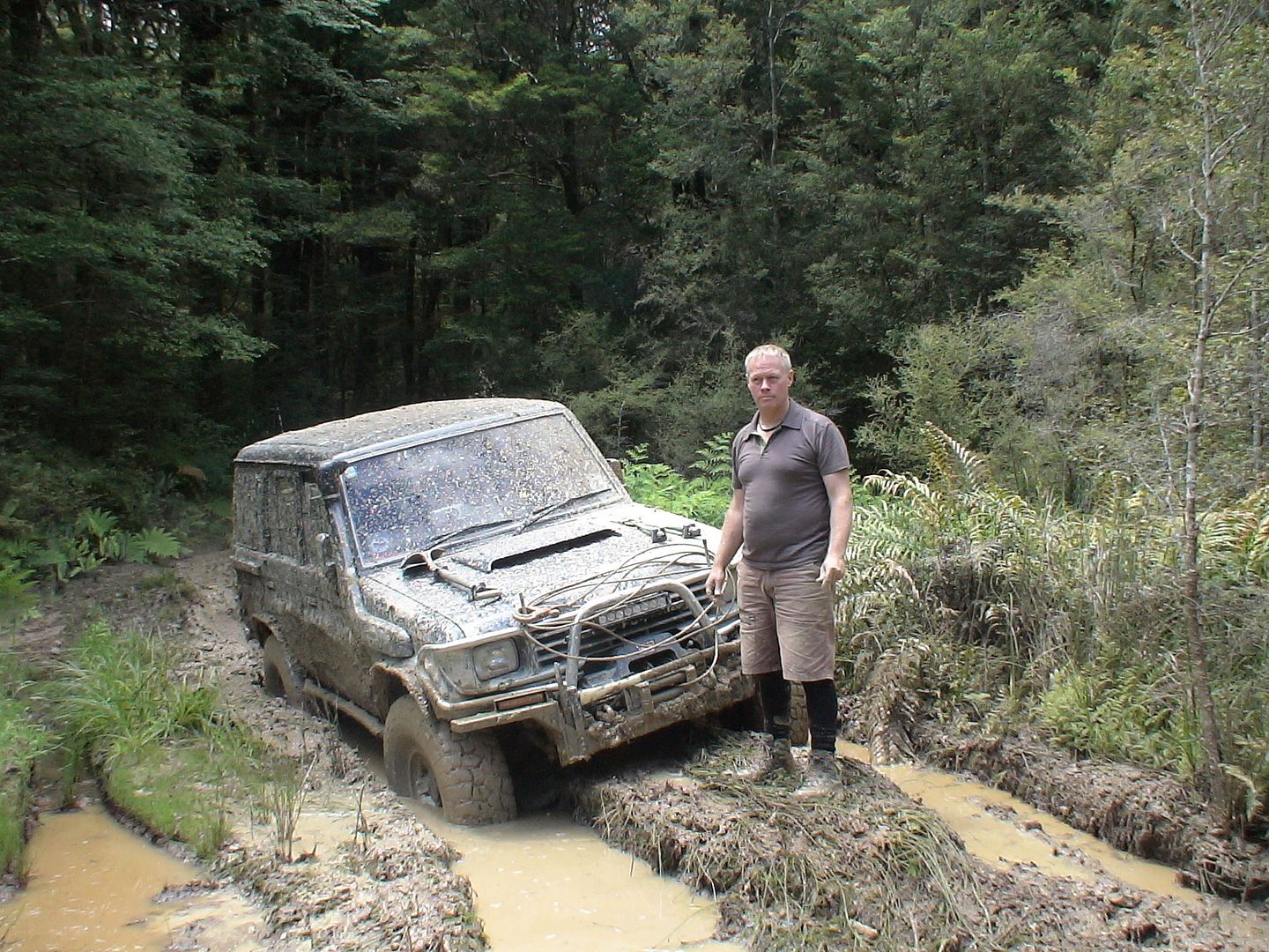

Why do you need a new motor Paul ? You got a problem
On the other side of the Reefton saddle after going up Trev's hill and down Cooze's track. A lot of winching as the ruts are very deep and even 36 simex's will not touch the bottom.
On a serious note. Warn claim these winches are water and shit proof.What a load of bullshit as I have had the same trouble as Paul and they just self destruct with condensation buildup.
