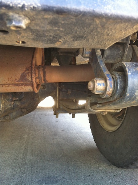

Here is a picture of the front passenger spring (the best spring) without any loading on it, no roof rack or anything empty truck. The drivers side is a bit flatter than this and the rear springs are flatter still.
You guys have been great with your input thank you very much.

that would be ideal if the rover had been loaded,
you could always add a leaf without retempering the original springs.
try swapping them left to right first to see if the truck levels out or gets worse

Here are all the springs under loading you can see the front isn't too bad but the rears are flat.
Im going to do what you suggest and put a leaf in and see if it improves anything before I start spending.
