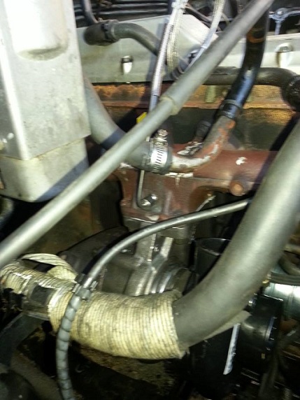

then same bits to add a bit of power
first a gturbo bad boy good for 20 to 30psi boost http://gturbo.com.au/
then a 3" Exhausts from Trundle (very nicely built)
a Intercooler from strx7 (needed a lot of work to make fit and tidy up)
then to tune it I got a
AFR http://www.ebay.com/itm/161174282508?it ... 60&vxp=mtr
a EGT gage http://www.ebay.com/itm/200739507260?it ... 60&vxp=mtr
plus a boost gage/controller http://www.ebay.com.au/itm/New-Genuine- ... OC:AU:3160
running about 20 psi at the moment still need to adjust the boost pin

Any fuel upgrades?
FJ62
toysuzi
Posts: 172
Joined: Mon Oct 09, 2006 12:00 pm
Location: nelson
Re: my 80
Post by toysuzi »
the fuel system is good for it just adjust the main fuel jet then mod the aneroid pin
