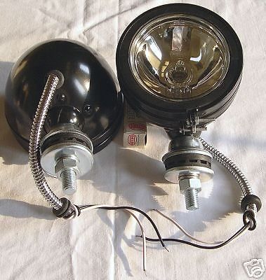

Ive bought 6 x 100w halogen 5" spots to mount on my roof rack. 4 on the front as driving lights and 2 on the rear as reversing lights.
Looking for some advice on how to wire these up. Size of cable, fusing, etc. Have read about relays on another site but not sure what they do exactly. Any help appreciated thanks.

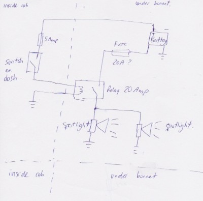

put the relay under bonnet close to spots but not where it will be wet all the time

You can reverse the wiring polarity for the switch so that you use negative to activate the relay. Save running positive feeds inside the vehicle. Reduces chances of shorts etc.
You may also want to wire some of them up so they come on with the headlights.
Matt.

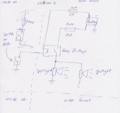

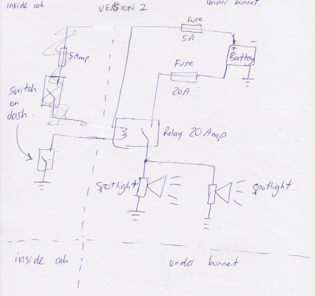

i think this is what matt means about switching negative
Mattman
Posts: 1643
Location: Kapiti
Re: Wiring up Spotlights advice
Post by Mattman »
That's the one.

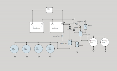

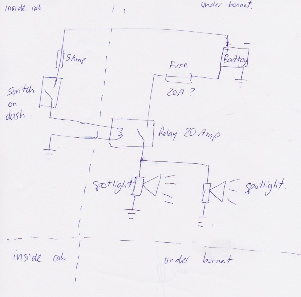

If my alternator can take it, is this correct?
I have a secondary battery that charges through a VSR unit. I have nothing running off this battery at present and is there for adding Aux electrical gear to when camping so I don't run down my Starter battery. I thought I would connect the lights to it.
If I have to upgrade my Alternator I will. It is currently (no pun intended) a 45 amp unit.
I have spent thousands on this vehicle so far, so a few hundred more won't make much difference :)
The only thing i'm still unsure about is the size of cable to use.

your 4 x front spots will draw 33.3A and the 2 x rear ones will draw 16.6A so your fuse for the rears could be downgraded from the 40A one.
Amps = Watts / Volts
For wire size I would suggest you have a look here http://www.energymatters.com.au/climate-data/cable-sizing-calculator.php

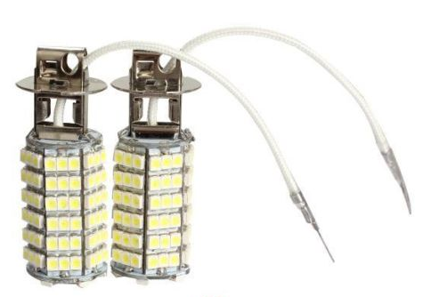

I could always change the bulbs to LED ones that would reduce the wattage a huge amount I think these run at about 6 watts

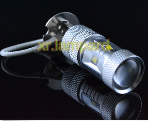

These high powered ones are 30 watts each

Your design shows you looping from one spotlight to the next. Is that actually how you want to wire it?
The other way to do it would be run four separate wires from the relay, one to each spottie. This would divide the current by four so you can run four smaller wires.
You would want to run 6mm2 for any circuit carrying 40A. So that's the circuit from the battery positive to the relay. Then if you ran four separate wires, one to each spottie from the relay, 1.5mm2 is good for around 15A. Each spottie only draws 7.5A so your all good there.
You also show the negative of your spotties connected to earth. Make sure there is a good connection back to your battery negative. 6mm2 if it carrying the current of all four spotlights.

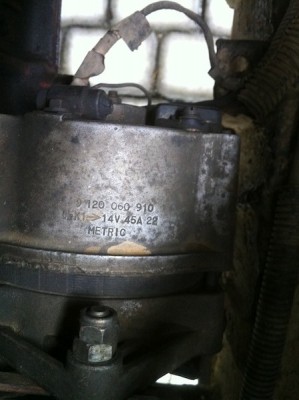

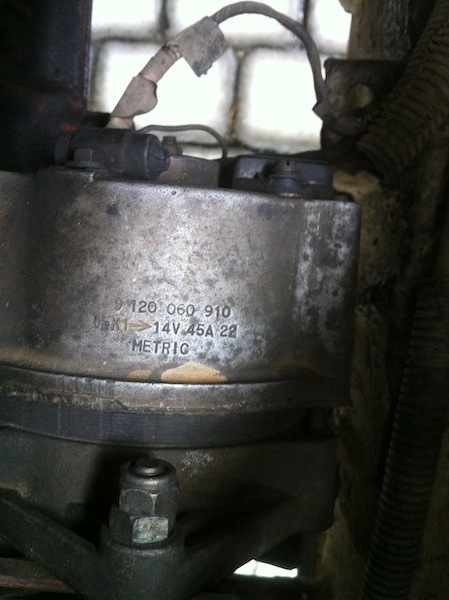

Also, looking at the pic of your alternator, I hope that is the alternator field wiring not the main charge wire wrapped up in tape. If it is the main charge wire you should run a new charge wire from your alternator to your battery positive. Suggest minimum 10mm2. 16mm2 might be easier to get hold of.
Using LED bulbs would significantly reduce the load on the alternator. You would be down to 8.7A with four 30W bulbs (120W total). Then you could run 1.5mm2 everywhere and it would be fine. 2.5mm2 can be a bit more mechanically robust and less likely for wires to break.
Pete

Agree with using lighter cable and fuses and relays for the rear two lights and I would do the front the same way with two 20 amp circuits even if you trigger both front relays off one switch.
Also as oldyella noted you don't want the four lights chained.
This way you have three identical circuits which gives you more flexibility for only marginally more cable.
If you run your headlights at the same time as your four fronts you will exceed your alternator output.
Bound to be an easy 80amp upgrade available.

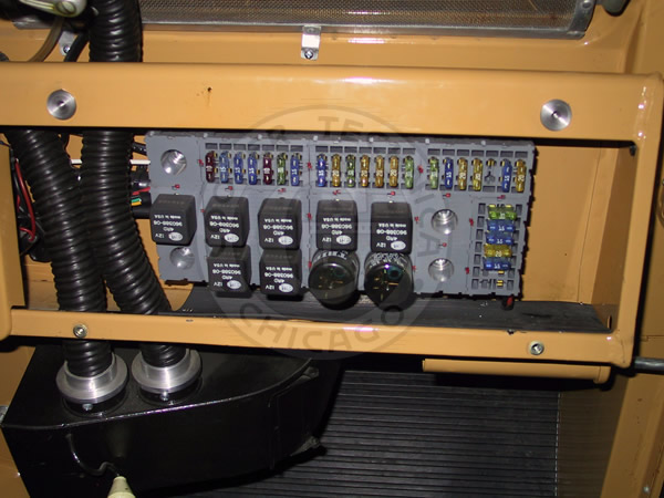

Solder all your connections and cover with shrink wrap and split tubing. Use relay holders and label your relays. Where the wiring goes through the bulkhead or radiator support use grommets. Get a nice fuse block as well, some come with relay holders so you can keep everything together and tidy.
Nothing worse than trying to find a fuse someone has installed somewhere! If cash is tight go to a pick a part and rob a vehicle of a small engine bay fuse box. It will have relays and fuses in it that you can just wire up.
Matt.

Thanks guys, I am going to run with lighter cables as you suggest and put 2 relays on the front lamps running 2 lamps each. I also think I will get some LED bulbs and see how they function. As for the cable coming off the alternator I think you are right Pete it is the main Charging wire. See new pic for details.
So one job turns into several - new alternator and new feed wire to batteries.
One day a set up like this would be sweet :)
