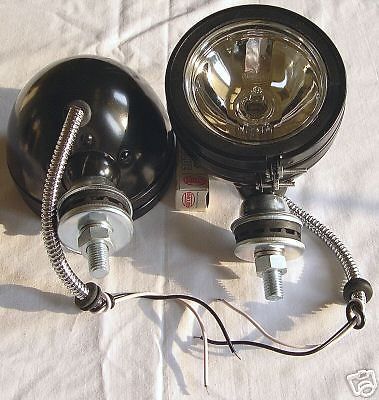

Ive bought 6 x 100w halogen 5" spots to mount on my roof rack. 4 on the front as driving lights and 2 on the rear as reversing lights.
Looking for some advice on how to wire these up. Size of cable, fusing, etc. Have read about relays on another site but not sure what they do exactly. Any help appreciated thanks.
