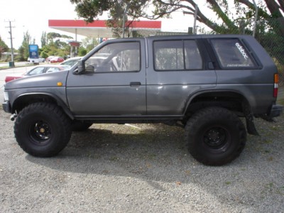

Hi all just started playing with 4x4 I have a 1991 Terrano lifted with 35" tyres great fun and just working through all the mods that need to be done with the steering as I have already bent two tie rods and an idler arm, so found that out the hard way.
Just fitting a steering damper now

35s are big for an ifs truck! Post some pics and update your profile with your location so we know where you are.

Thanks Mate yeah I was thinking of using the steering box to replace the idler arm. Are the 2wd tie rods bigger? Stronger do I still use the existing main steering arm
Will post a photo as soon as I work out how to reduce the file size of the one I have lol new to this stuff

Im really interested to how you got 35s to fit on a rano.

ya must have a epic lift ? rear guards cut out ? diff moved back. am keen to see pics to.

Will put up photo as soon as I can resize has 3" lift with 2" body lift,
looks the part :wink:

nice looking truck...have you had any trouble with cv's ?
