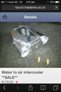

Mehrts wrote:What intercooler did you use for this?
i used this intercooler and this is the trade me seller i purchased it from new. I cost me $198.00 for the cooler and $235.00.00 for the pipe work which included the new 3" introduction pipe.

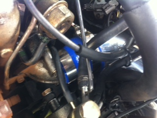

This is what I have done so far. i have relocated the air box to the front under behind the headlight.
Induction piping components-
*3" 90 degree Aluminium pipe section
*2 X 3 inch-2 1/4 inch Silicon junction pipe
*2 x 3 inch hose clamps
*1 x K&N E-2210 Filter
Intercooler piping components-
*2 x 2.5 inch Silicon joiners
*1 x 2.5 inch U-bend aliminium pipe
*2 x 3-2.5 inch silicon joiner
*8 x 2.5 inch hose clamps
You will need to cut all the pipe sections as you go so that you get the best fit possible.
Good Luck
Hope this helps you to get started:)

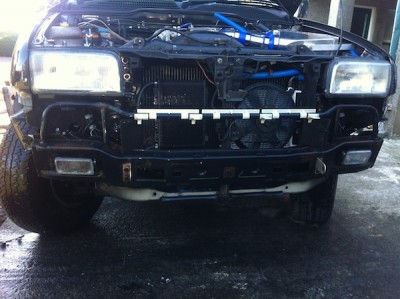

Here's how I set up the radiator for the intercooler. I have removed all of the air conditioning to allow more room to fit all the upgrades and who really needs a power sucking airconditioning compressor anyway!

dion31 wrote:Here's how I set up the radiator for the intercooler. I have removed all of the air conditioning to allow more room to fit all the upgrades and who really needs a power sucking airconditioning compressor anyway!
you'll be kicking yourself when your in the bush and need an air compressor big enough to seat a bead. 8)
