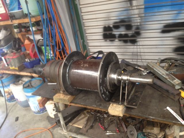

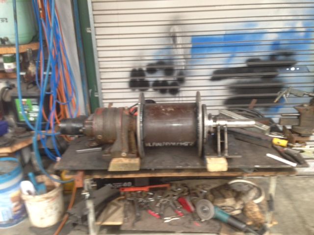

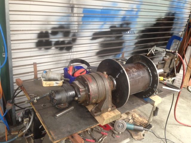

this may or may not work but....
ignore the mess around the bench :oops:

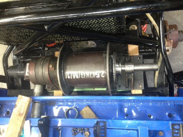

Wider drum would not bunch so much on a long pull, as would run off drum at speed.

its mid mounted so the rope should follow the same line each time...all going well
the rope comes in from the top of the photo (rear of vehicle)
the blue section is the rear of the tub

I could only fit 60 metres of 12.5 Amsteel and my drum was 500 =250
It would fit more but the speed make it jump the drum.

my initial concept was for 50 odd meters which should fit with 3 full layers. after that i will use the balance as extension rope.
if the cost gets to far up there i will settle for 60 meters and get the extentions at a later date
