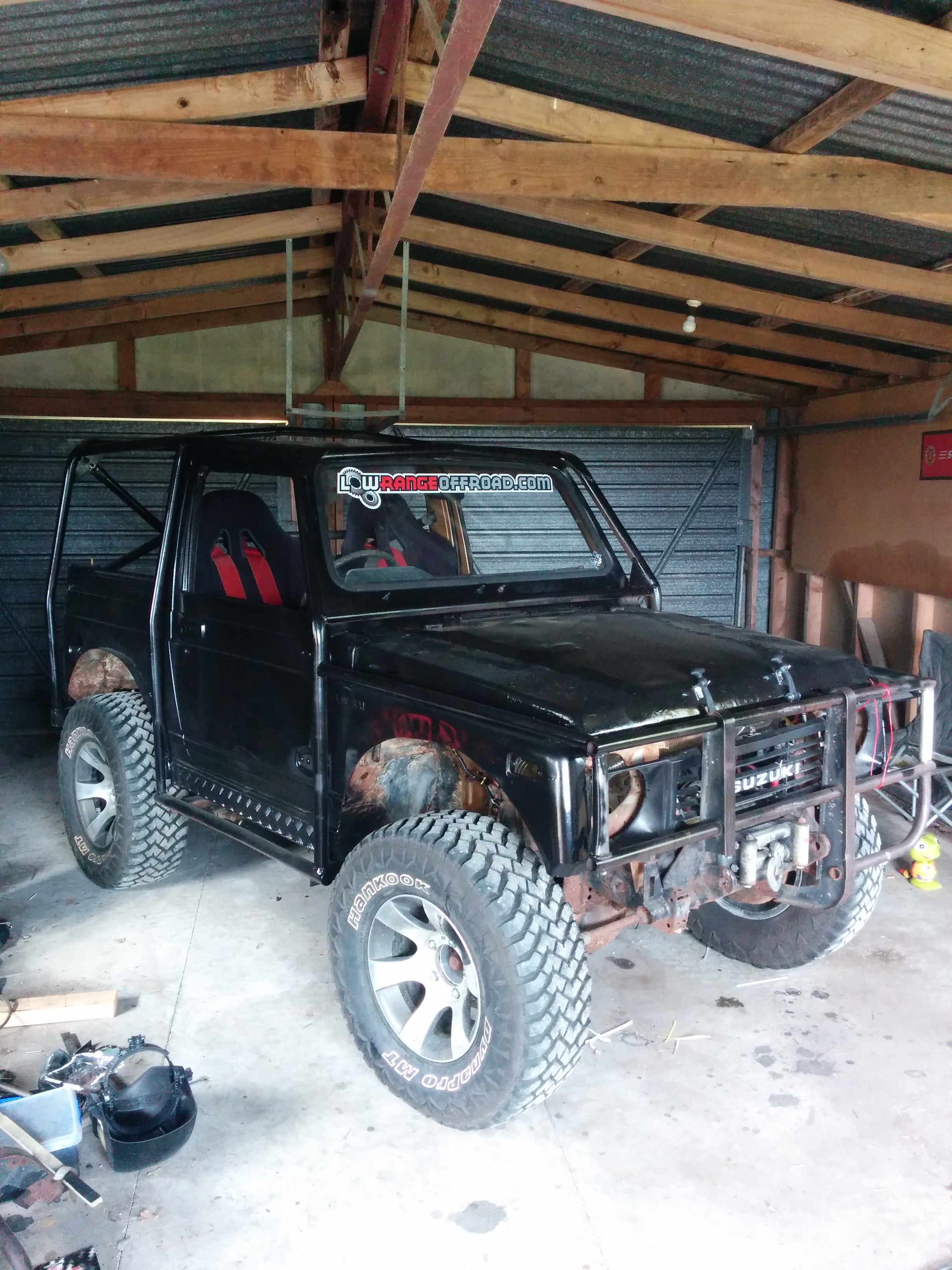

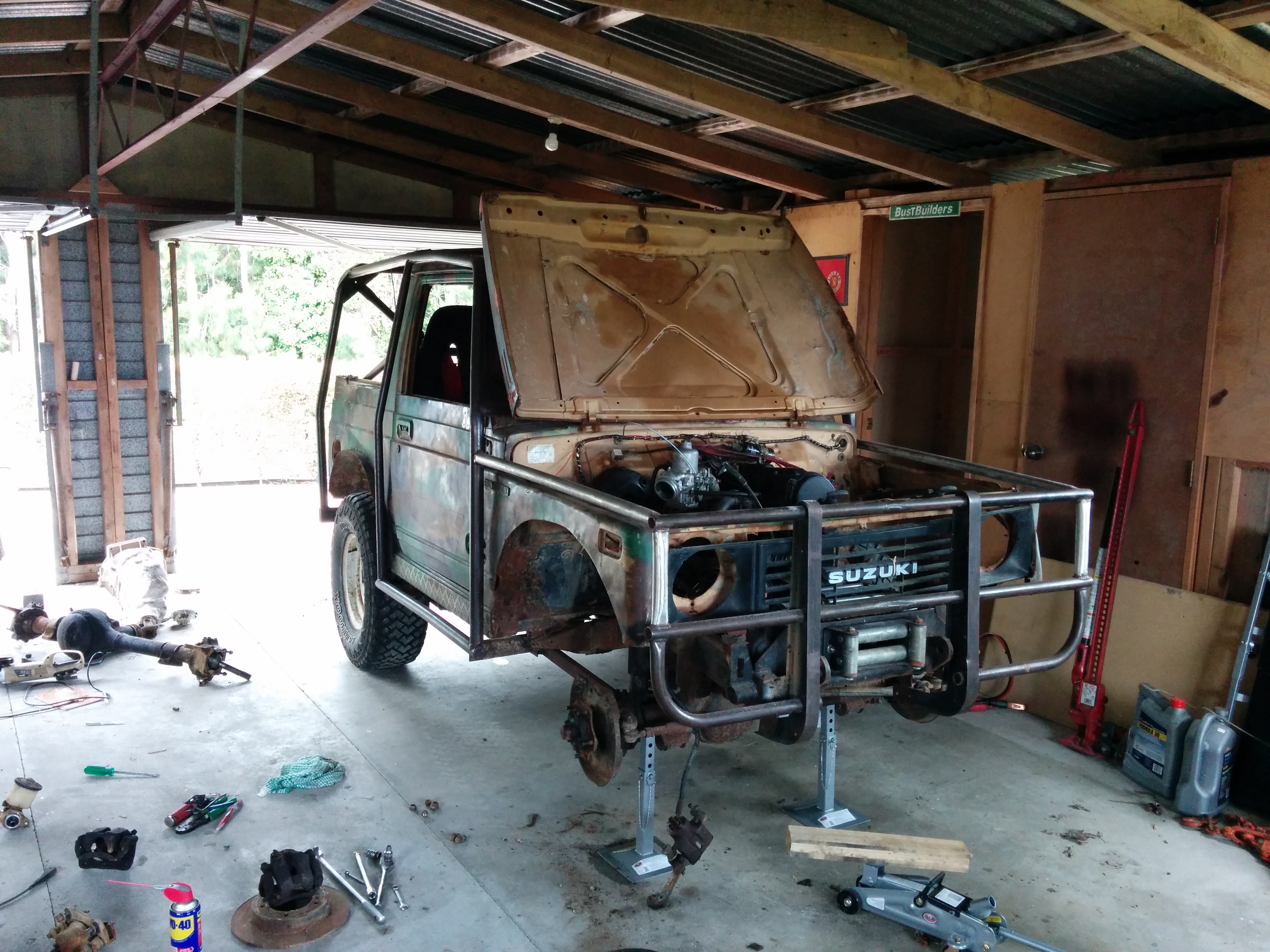

A 1987 SJ413, stashed in the back of a farm shed, a fair amount of rust, no seats, no engine, and a set of bald 30" ATs. But looked like it was once someones loved club truck from the build quality of the cage (not counting the bullbar, looks like that was a farm addon as its not even centered), it has a 3-link coil front, and there are brackets on the chassis that appear to be the start of a 4-link rear which I doubt a farmer would have bothered adding, rear mounted radiator, winch mount where radiator would be, and the start of a rear disc conversion.
At this point now its got a pair of race seats which I scored for $100, just factory looking ones from probably a GSR or similar, faded and one ripped but perfect for this use.
A carby G16A with SU carb conversion and stainless extractors, which has finally found its home in the engine bay, runs and drives al-be-it not very well yet, still seems to have a vacuum leak or timing issue to sort out.
Engine bay wiring loom completely stripped of everything not needed rather than a ton of wires chopped off and hanging everywhere as before. Just need to do the same to the dash loom and make available unused circuits for other things.
The 31s I kept from my hilux have now been swapped to the Zook rims.
The rear roof had more rust than I could be bothered with so off that came.
And at this point it basically now looks like this:

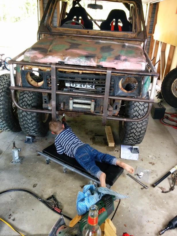

Well after a few weeks and finally off the axle stands again for now, probably time for an update, with pics or it didnt happen :)
Actually got quite a bit done over the last few days, enough to go for another motovational blast around the section :lol:

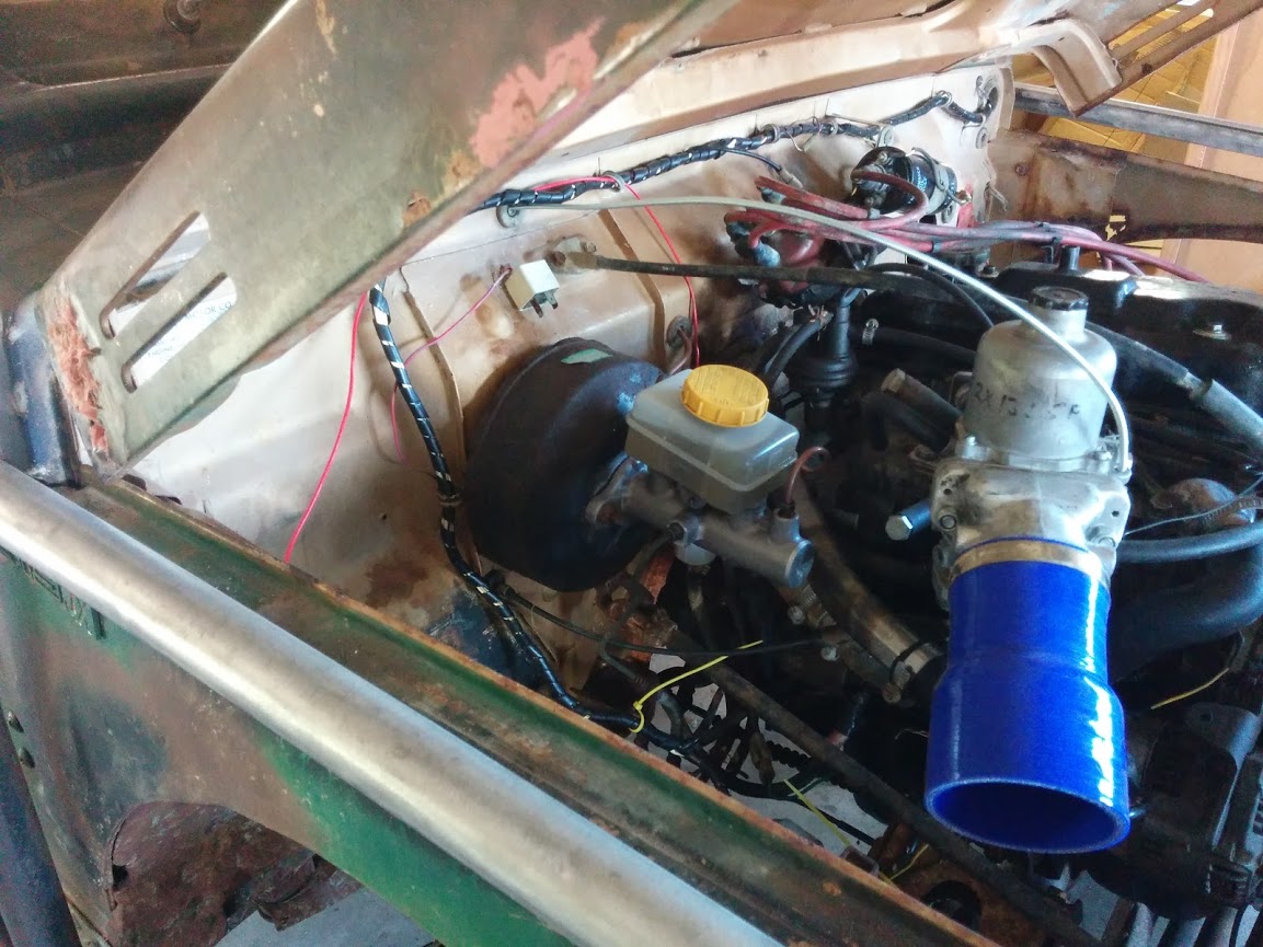

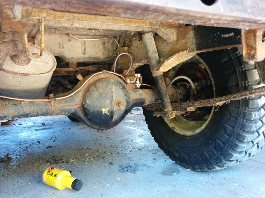

Completed the Subaru master cylinder upgrade..
..and got the rear disc setup finished and plumbed, as well as the Vitara calipers on the front, tested, still needs more bleeding I think, parking lock wont hold on, but actually stops now

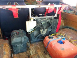

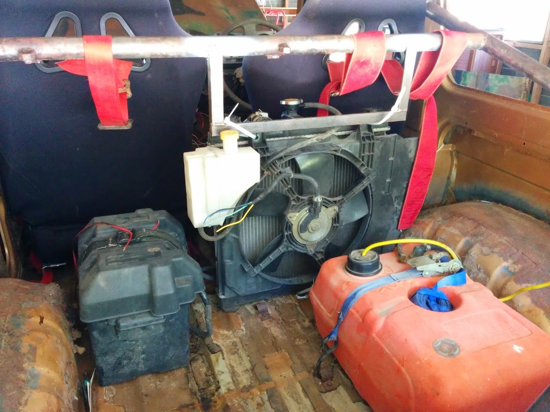

Also re-arranged how everything was mounted in the boot and got the new radiator mounted up, just got to wire up the fan so both speeds work. This setup allows the hoses to run straight down the center rather than under the passenger seat, and the bit of extra length gained allows more airflow behind the seat, it was very close before.
And of course mini-me, chief project supervisor is checking all my bolts are tight.. or trying to undo them :twisted:

So thought I should chuck up another update from the weekend. Didnt get a huge amount done, still trying to figure out the overfueling and high idle problems.
Moved the left side engine mount up and added more spacers this makes a lot better clearance with the extractors and the top link. Hacked the flange off the extractors and started welding a pipe in, decided i really dislike welding upside down, blew a hole then created a huge mess trying to weld it back up haha so decided to leave that for another day after Id calmed down haha.
Air intake.jpeg (20.53 KiB) Viewed 6347 times
Did get the intake finally made up, filter in the glove box, simple but works and cant get splashed, probably wouldnt be too keen fording water that high with a petrol engine and a truck that light anyway so should be fine

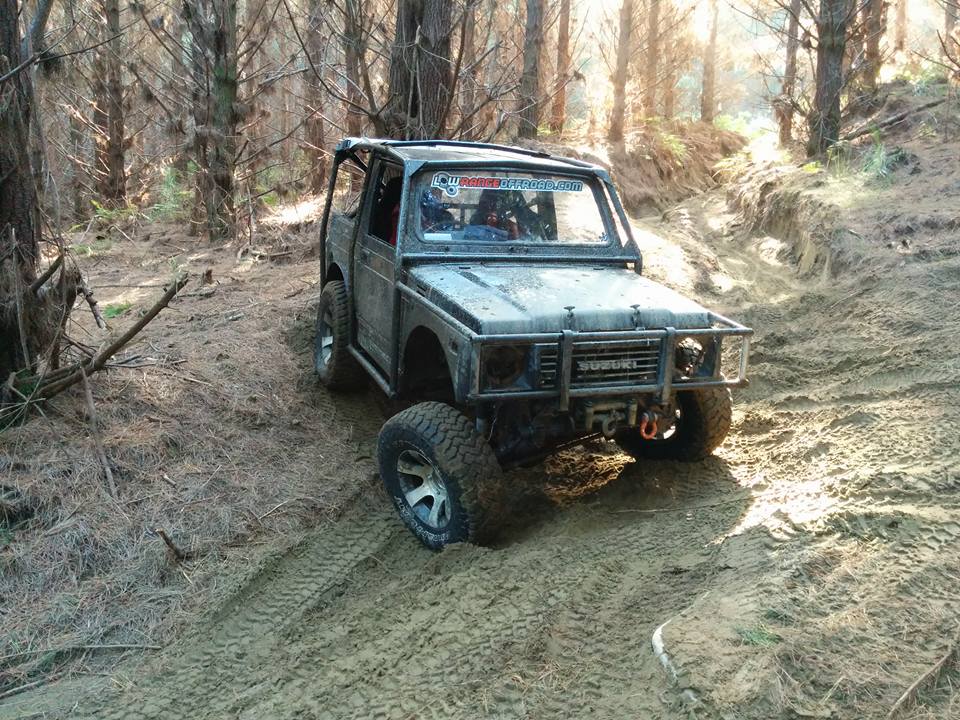

Finally I can say its had a good testing.
Took it up to Woodhill on Sunday. Went sweet as a nut all day everything ran mint didn't even have to adjust anything. Very impressed at how the little beast goes.

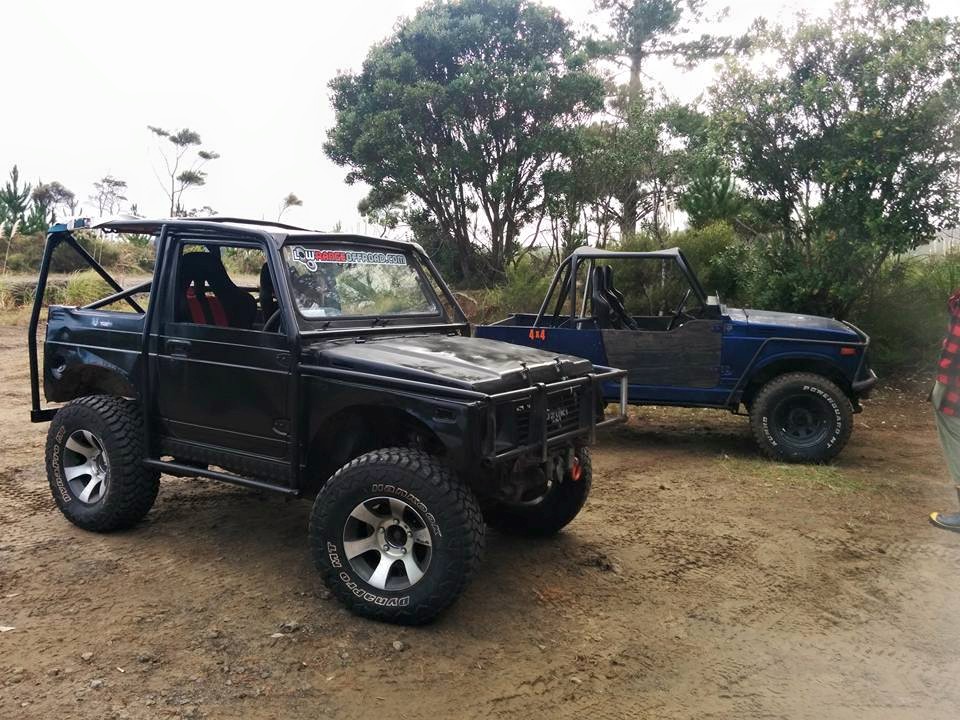

This is how it looked as it came off the trailer Sunday morning, before it got dirty:
