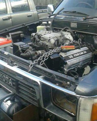

Body swap done and in the prosess of doing the 1uz swap slowly geting there

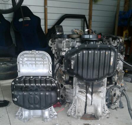

Was a mission finding this one

All in just got driveshafts and radiator etc left to go
