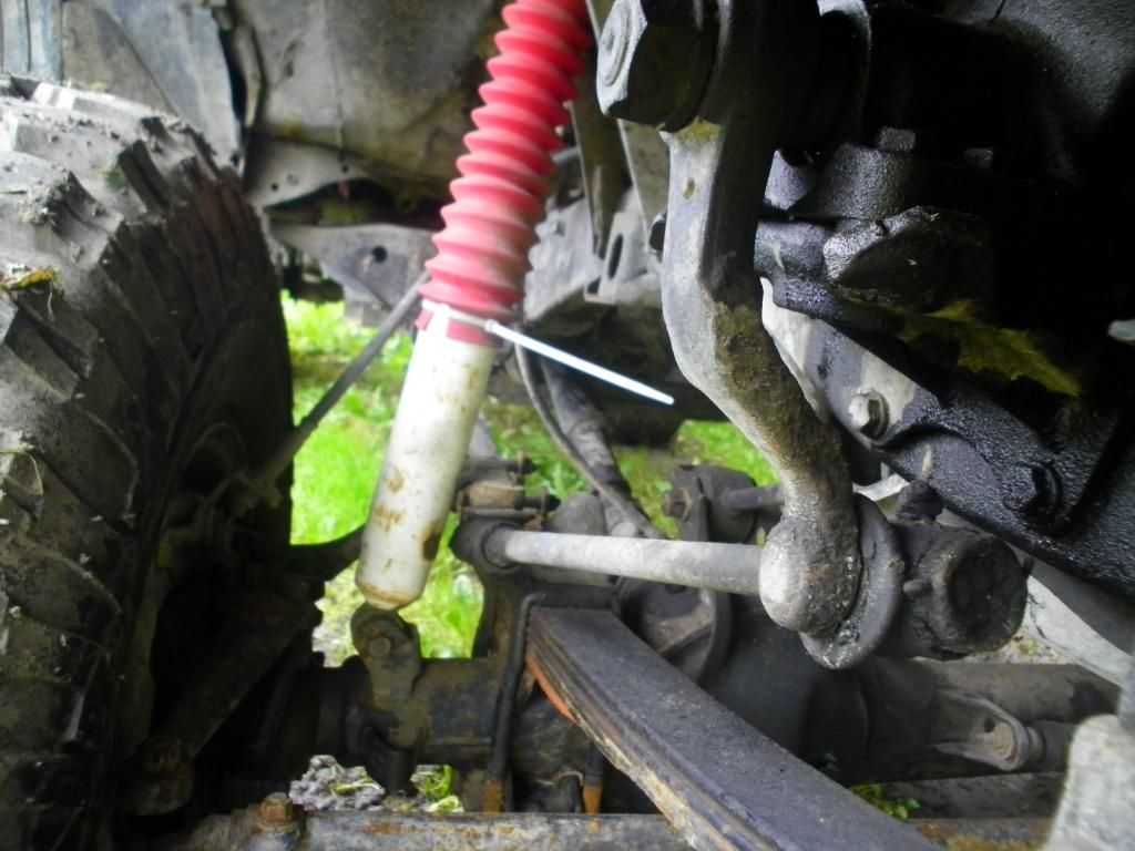

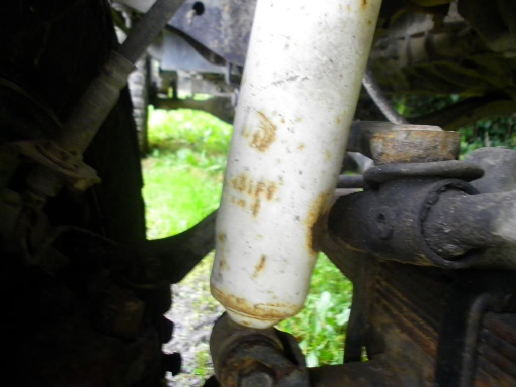

Hey guys I got a Ln65 Hilux. 3 inch shocks with 2 inch body lift on leafs and when I'm in full lock right I think it's the control arm? Unsure exactly but it pushes against the drivers side shock only just noticed this and it's too late since the shock now has been dented.
What is the solution to fix this and will a dented shock fail me on cert?

Trundle wrote:do you have a pick of the issue, we stock a number of front end parts for your truck ,
http://i1003.photobucket.com/albums/af1 ... NY0030.jpg
http://i1003.photobucket.com/albums/af1 ... NY0029.jpg
Here's the pictures.

Thats the draglink for steering, would adjusting steering stops help

Wolf wrote:Hey guys I got a Ln65 Hilux. 3 inch shocks with 2 inch body lift on leafs and when I'm in full lock right I think it's the control arm? Unsure exactly but it pushes against the drivers side shock only just noticed this and it's too late since the shock now has been dented.
I think its caused by the larger bore shocks and the suspension lift, it should get slightly worse when you flex with compression on the drivers side?
Possible solutions are:
-Smaller bore shocks my old man emu ones are fine but im only around a 2 inch lift, what's the o.d of the bit on the shock that rubs? i could measure against mine if you like
-Ditch the standard steering and do the high steer conversion but that's mighty expensive but the ultimate fix to the average stock steering
-Or as mentioned above limit the steering some more but they have a crappy enough turning circle already.
