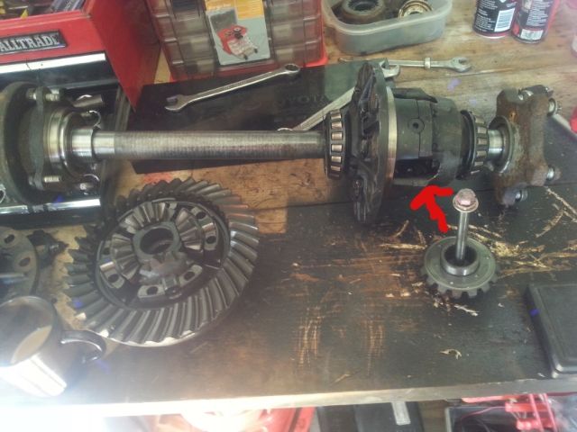

Now how do I get this in there? :? Mite start by opening it :lol:

tatnz wrote:Now how do I get this in there? :? Mite start by opening it :lol:
Check spline count is compatible by removing r200a side flange and try in c200 lsd sidegear. They most likely same @ 31spline, but lsd could be 33 spline if d22 era

by tatnz
And I guess this goes in here to hold the stubby axle in? is this the only mod needed

by lax2wlg
tatnz wrote:And I guess this goes in here to hold the stubby axle in? is this the only mod needed
Not the whole side gear... just the threaded dowel thing, its pressed in. You'll need to remove it and gently press it into the LSD side gear using a slide hammer or similar.
Rock onwards! :D
ps also when you strip the R200 down mark all the bearings/races individually, don't mix up bearing races. Also take notes/photos of the number of shims on each side of the carrier bearings. Reinstall exactly as they were, this way the carrier bearing preload settings won't be upset.
Are you changing gearing?

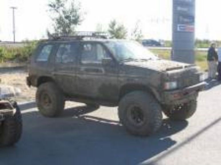

Just abit of an update
3'' Rear springs in with new shocks and 2''BL :oops: look at the small 32s :x
2'' rear springs and 2''BL and the local fire brigade :roll:
I don't know if I want to put the 3" BL in the thing looks high as now :roll: but if I want the 35s under there I guess ill have too :twisted: .
What are your thoughts :idea: man they look good
I don't wona end up like this chap :lol:
Re: the rebuild
Posted: Sat Nov 01, 2014 7:51 am
by passengerpete
might pay to check if ya can get certification for the 3'' body lift before ya put it in. as im sure max is 2'' but I may be wrong. with the 35'' tyres are ya moving the rear axle back or tubing gards ? keep up the good work.

by tatnz
I was going to cut right up to where the door meets the body and then make and weld steel flares and the front guards will be cut about the same. Kind of like this
