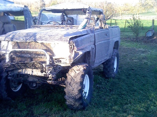

flick me your email if you want some photos of a backyard "bush truck" style.

The motor should be able to fit if its just a bush truck (not certed) - iv done the conversion on the rugger and iv got 2 mates that have also done it in a little suzuki farmworker and a surf but all in backyard bush truck styles.
